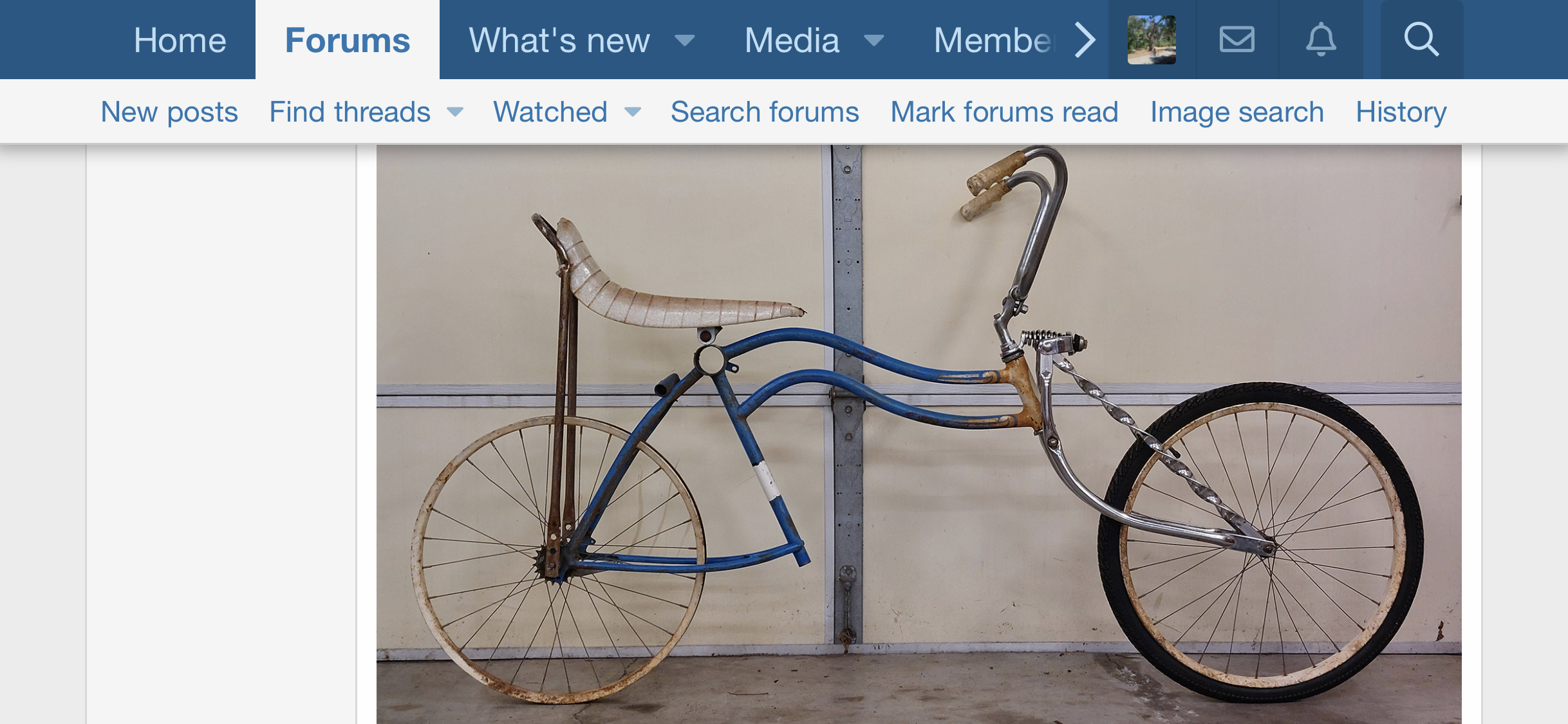

I picked up this step-thru Foremost Murray for free last year at the Haysville bicycle swap meet. I originally got it for parts and tubing bends, but I decided to play around with it during this whole "Mockup Mash."
I didn't even mock it up until I was almost ready to put it up! I was cleaning out the garage and loading frames and parts into my car to take back to storage when I decided to do a very loose mockup of this bike. What set it off was this handlebar and handlebar stem that almost perfectly matched the blue paint of the frame. I found a set of white grips and a white seat to go with the white paint, and then took the front fender and mocked it up as a bobbed rear fender. And just like that, I decided that I'll throw this bike together this way. I'll likely use a set of whitewall tires and maybe some white pedals too, but just laying the all the parts on the floor like this was enough to help me decide what to do with this bike!

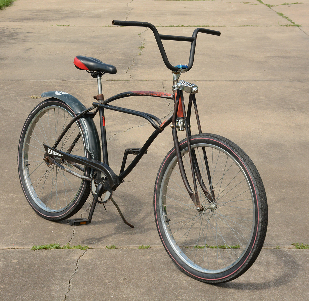

While I was down in Texas last month pet-sitting for my brother and sister-in-law, I sketched up a few ideas for some more bikes I'd like to build. Among the ideas I came up with was taking a JC Higgins Colorflow frame I bought back in April and turning it into a BMX-style "street bomber."
Normally when I sketch a bike before physically mocking up parts, the idea winds up looking better on paper than it does in practice. BUT NOT THIS TIME!
While I couldn't mock up all the exact parts I wanted to use (the fork's steerer tube was too narrow for all but one of my BMX handlebar stems,) the mockup was all I needed to know my idea worked, and even better than I expected! The only thing that didn't work from my original idea was using a pair of pink wheels, a pink seat and pink handlebars to accent the red, blue and black paint on the frame. It sounded better in my head, but eh, my second option for chrome, silver and black accents works better anyway.
There's just one small problem with making this bike a reality: The rear triangle is bent to the left, leaving the rear wheel uncentered. I think I can fix it, but I've never messed with the rear triangle of a bike before, so I'm not sure.
You can improve the wheel centering by adjusting the rear triangles. Search for "cold setting" here and online. It looks like you need to push both sides to the left a little. Use a 2x4 and the ground. The steel frame is pretty resilient. Try adding more and more force to the 2x4 until you get the frame to move where you want. The fork ends need paralleled (lined up) and will need adjusting once you get the triangles where you want.
