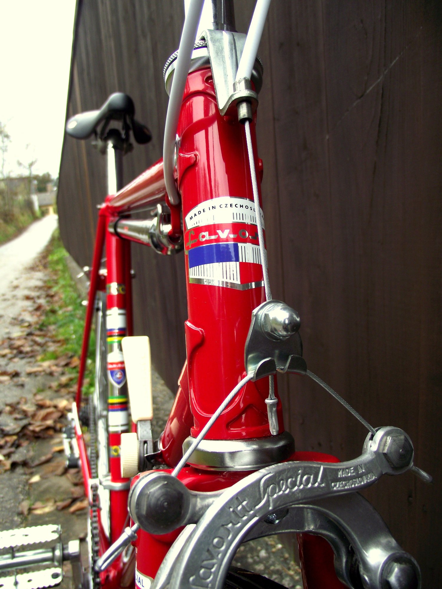

Something I've been working on the last couple of months: early '70s (73?) Czech made Favorit. Solidly made bike with most components made by Favorit (crankset, BB, brake set, shifters, derailleurs, pedals); OE Maillard wheels, SR stem, unknown bar, and Tioga "Bear Trap" headset (I assume that the OE headset was an in-house part). Rear dropouts are knurled. Not one of their pro racers, but still a decent frame. I do not know if the "Special" on the fork decal is in reference to the bike model or the tubing. The paint needs help, but I'm just going to touch-up and preserve what is there. I have a couple spare original chainwheels and cranks that look better and one needs to be installed with some new tires and bar tape. I have an an old SILCA pump in celeste color with the Bianchi logo which might fit this frame otherwise a chrome finished pump will be used. I also have a Soviet Union period leather saddle bag and tools to give it a little more authenticity.

Original stem would have been a FAVORIT bimetal -
1289084
Original hubs would have been marked either Favorit or ESKA.
In the middle of the flute on the outer face of the OEM crank arms there should be a symbol of three interlocking rings.
Bicycle's PWB model rear mech stands for Prague-Warsaw-Berlin; a race sometimes referred to as the "east bloc Tour de France."
The U.S. agent for Favorit bicycles at this time was called American Jawa and was located in Valley Stream, NY.
Favorit badge used for sports models. The same maker produced cycles under the Jawa, Pioneer, Rapido and Velamos badges. Jawa and an Rapido badges were employed for practical adult transportation models. Pioneer was a juvenile badge. Velamos was another sports badge.
The export group for them was called Motokov Praha. They were also an agent for chain hoists, Barum tyres and one or two other product lines.

Thanks, I already knew the SR stem was a replacement, and I have an original stem coming my way. I was questioning the wheels, but as with many European bikes they could be purchased with other components based on a buyers preference. I need to date the Maillards to see when they were made, but even then they are staying on it; they ride fine and I'll take what was probably better quality than the Favorits for that bike. Their race bikes were not using Favorit parts, but a Campy group from examples I've seen. I have seen the Favorit badge on their higher end race bikes; I wouldn't mind finding one from '68 due to their Olympics success at the time. My original cranks (not in photos, but now on the bike) are not fluted. Are you familiar with the Velidest (I think that's what it says) saddle? I couldn't find anything about them.
That is not the Favorit seatstay cap they used on every other Favorit I've seen. Yours also has more chrome. I think it might be quite "special"; lucky man.

Favorits are full of surprises and contrasts. The hubs have double-labyrinth dust seals, ground cones, excellent locknuts - and the brand stamped on crooked. The stem has the nicest wedge-nut I've ever seen - looks like a high-quality forging, has a key in the cone surface. Who sees that? The front mech has a cable-routing that I've not seen anywhere else, and the graduated surface for the limit screw to bear on is formed by the curve where the rod is bent downward and drilled for the cable attachment bolt.
thanks very much for sharing your example many408!
your machine appears to be a bit later than that of Jesper.
note the pump pegs. those on the Jesper machine are simple while those on your cycle are the later type which incorporate a housing stop. this type is also seen on the F12 model bicycle posted above.
the red plastic centres on the QR nuts of your bike are something which came in around 1976 or so.
seat stay treatment -
the style on your frame was also used for Rapido and Jawa badged transportation type machines whether one, planetary three or derailleur five speed models. have a green Rapido badged five speed in me racks with this style.
in Italy, the lug manufacturers Agrati and Malaguti had a seat lug design which was the reverse of this. the lug incorporates plugs which go down inside the seat stays.
this is known as "Malaguti style."

kitting note -
models below the top-of-the-line pro bikes had no non-Czech content. the nation produced everything including gear blocks, drive chains, spokes and rims.
the top pro model road machines had frames of eleven tube 531 with Campag 1010 ends. the very top model was all Campag NR kitted. there was one model down made with the same frame and mixed road ensemble of Campag NR components and Favorit ones. it had Campag chainset, hubs and gear ensemble paired with Favorit brakes, pedals, etc. had the opportunity to see one of these latter bikes in the showroom of a LBS in 1972. finish was a darkish red flambouyant.
