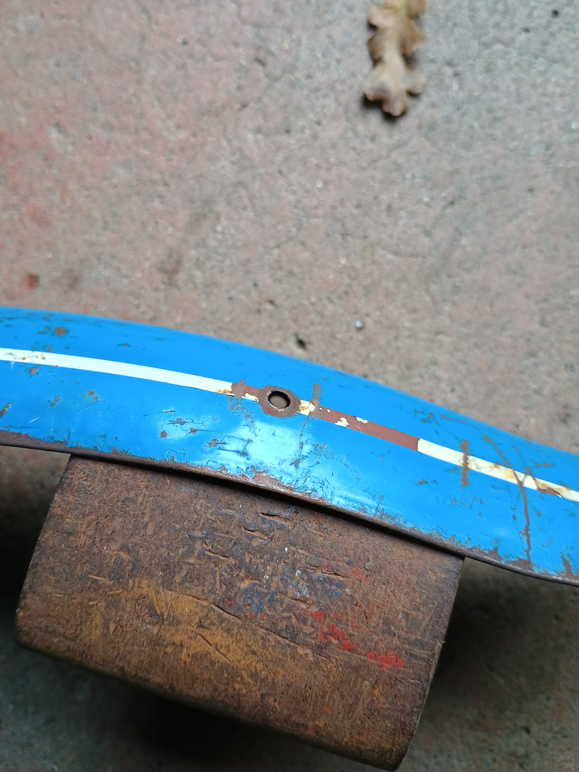

EXAMPLE #26
Shot some video footage for this job. Started at the nose. Seemed like a good place to start. Had to lube the top wheel. Was sticking too much and just sliding across paint and not seeing the rolling action I wanted too see. But after lube spread out bam! Smooth...
Next was the flared end. Back and forth moving side to side to flatten out the highs
Those fender braces when they get loose often stretch fender metal out on the edges of the brace. Common problem I see over and over. Knocking down the highs here....
And the pin stripes started to parish...never know if they will stay or go....
With the help of a crescent wrench had to work the edge back into the line nice and easy as not to over do it.
Hammer and Train Rail Dolly next on the job.
And so far so good. Minor stuff to address. After all the cleaning still specks of tar slowed me down. Overall turned out great regardless.

Man, this is not a post, its a tutorial! Great videos and photos. You're doing metal finishing with the "paint on". Perfectionist! Great work as always and thanks for posting!
I enjoy you taking the time to share this information with us.
Just a couple of general observations.
The hammer needs to have a "flat head", when taping on top of a crowned fender. The slightly curved head on the ball peen hammer displaces (as in stretches) the metal with each blow. You might look into using the "hard nylon" hammer's when working on the thin metal of a bicycle fender to reduce the metal stretch. Every small dent in a fender "is a metal stretch". Since the dent is a stretched area, use the dolly under the dent, and use the flat head hammer to lightly work the area "around the dent". Metal guys refer to this as "off hammer". If the dent is just hammered up from the bottom, it does not shrink the stretched metal from around the dent.
The metal working tools need to have surfaces that are "ground smooth". The hammers, and the dollies should be mirror smooth, or they will transfer their imperfections into the work. It's the same reason you took the extra time to clean the tar from the underside of the fender and keep your rollers spotless clean and smooth.
You will likely need to "hand make" some of the special tools needed, and they will be better than store bought. Car spring leaf's are a good source for metal. One of my favorite dollies is a huge "domed" valve out of a diesel engine, for example.
John

Thanks for the info. I actually do minor taps at an angle to lower the high point and then use the roller to get to the edge and use the crescent wrench to get it even more in line. Hammer I use is pretty flat.
Whatever you are using and doing - keep it up! That blue fender looks brand new. That blue paint is still so nice, and you have that fender so smooth again that once its all mounted up its gonna look MINT!
If any area you work on starts hopping and bouncing all over the place most likely you have a dent or ding that needs to be leveled or you have a glob of tar , grit or mud of some sort that needs attention before you move on. Once it's flat then when you roll the area you won't get those hops
But it's also good to check the inside to see if you can see a high or low spot. Often turning the fender in good light you can see areas you may have missed. Following the line in the this you clip you can see where it needs rolling. Can you see it?
Only minor details left and off to the next.
Until next time !!
