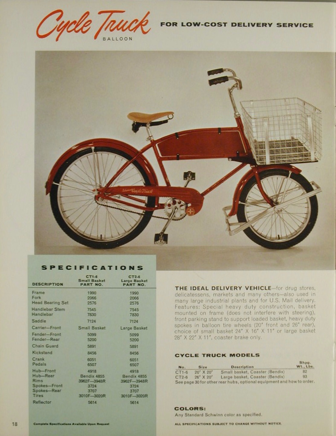

August 30th 1960 ?
That serial number shows up again for that frame style on August 30th 1962, but that four hole clover style sprocket was an earlier feature on the Cycle Truck, so my gut is telling me that it’s probably a 1960 model?
This from the 1960 catalog.
(Note the catalog already depicts the later Sting Ray type “Bubbles” sprocket.)

Woah, neat flyer! This definitely could be the black one!
I believe it the serial number reads H77338! It was on the left rear drop above the nut just as you said!
Schwinn simplified its SN system in 1958, and there is no way possible the number you posted would fit 58 and newer.
From where you found it, it would be a 53 - 57 SN. Unfortunately there were duplicate SNs in that time frame.
