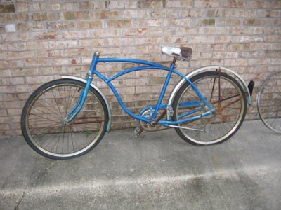

Building a Whizzer is not hard at all. I have about $800 so far into mine and it's not complete yet. I already had the bike, a 79 Spitfire. The motor & tank came free from a family estate. Rest of the parts I cobbled together from EBay & Memory Lane.
I'm a mechanic by trade so labor is all on me, only thing outsourced was straightening the rear wheel. Here is a pic of the motor before rebuild. More pics on the way.

If I can do it, you can do it. Got a lot of help from the Cabe and motored bike forum members. My investment wasn't for resale, but correctness. I wanted my Dad to see the bike as he did when he bought it new in 1947.
