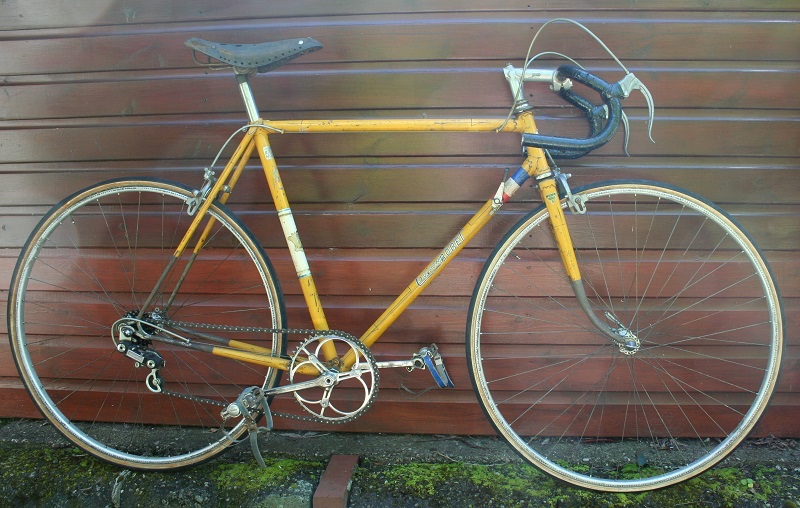

Is this a Schwinn Paramount?

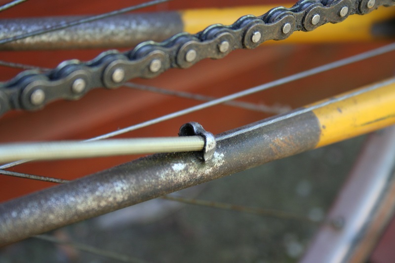

note subject frame's double chainstay stop
this is a helpful dating aid
both Juy & NERVEX offered this fitting
the NERVEX is Ref. 872 or 872bis

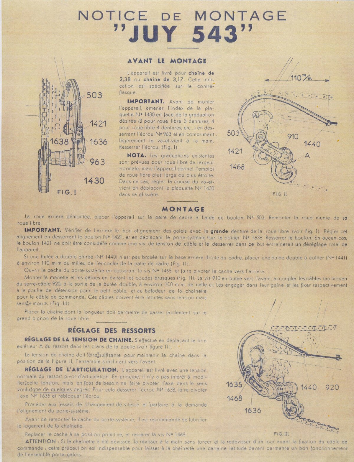

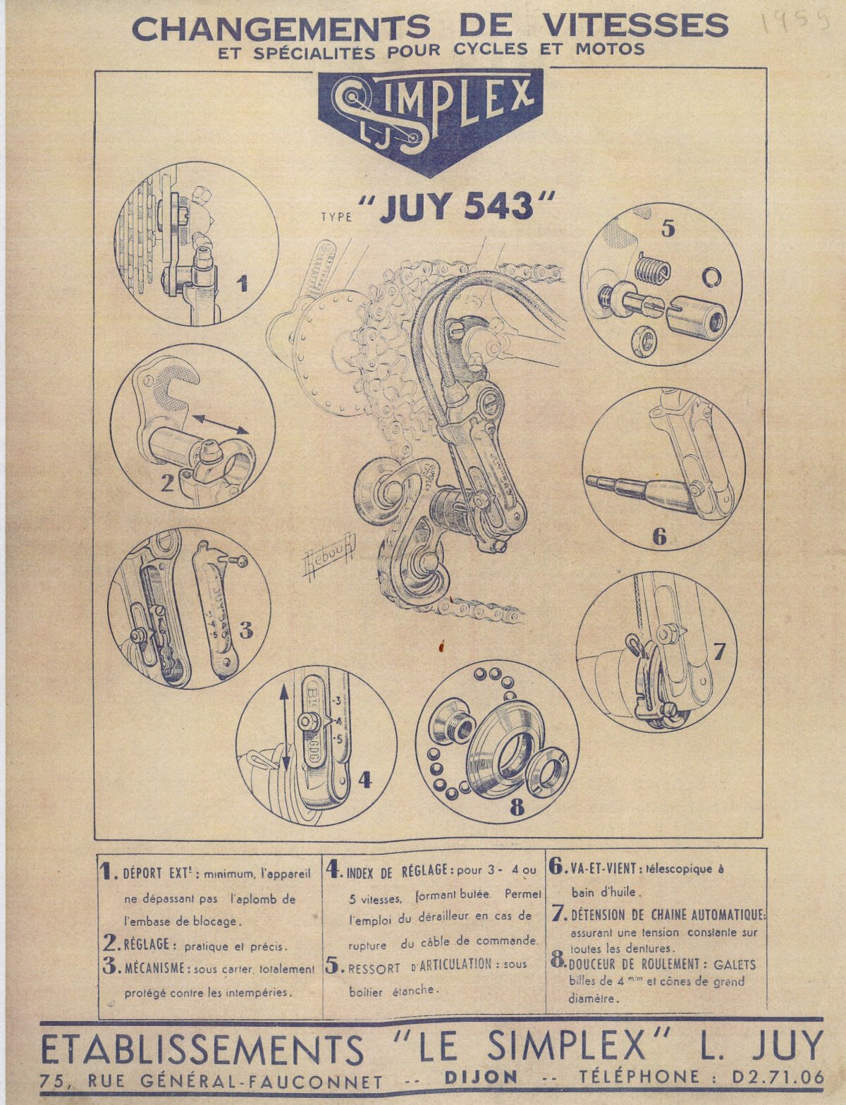

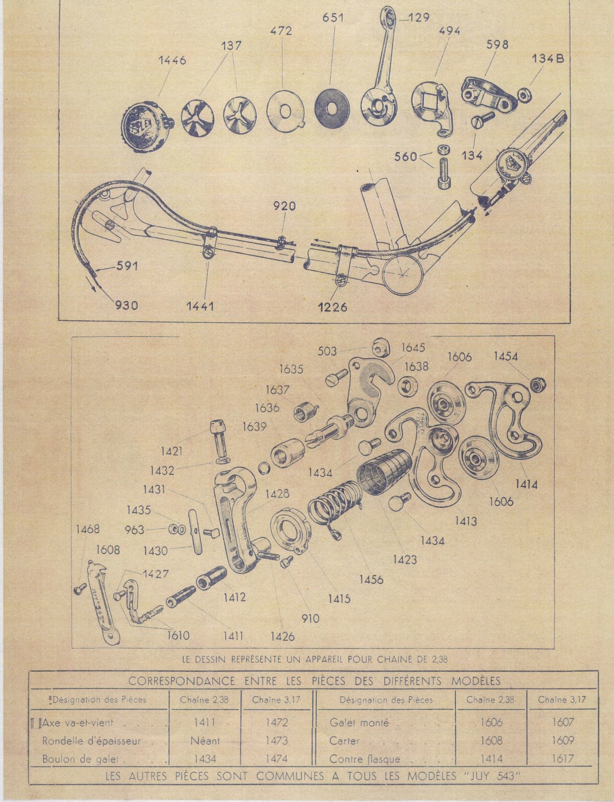

given caliber of frameset and presence of Juy endset it is likely to be intended for the Juy 543 gear mech:

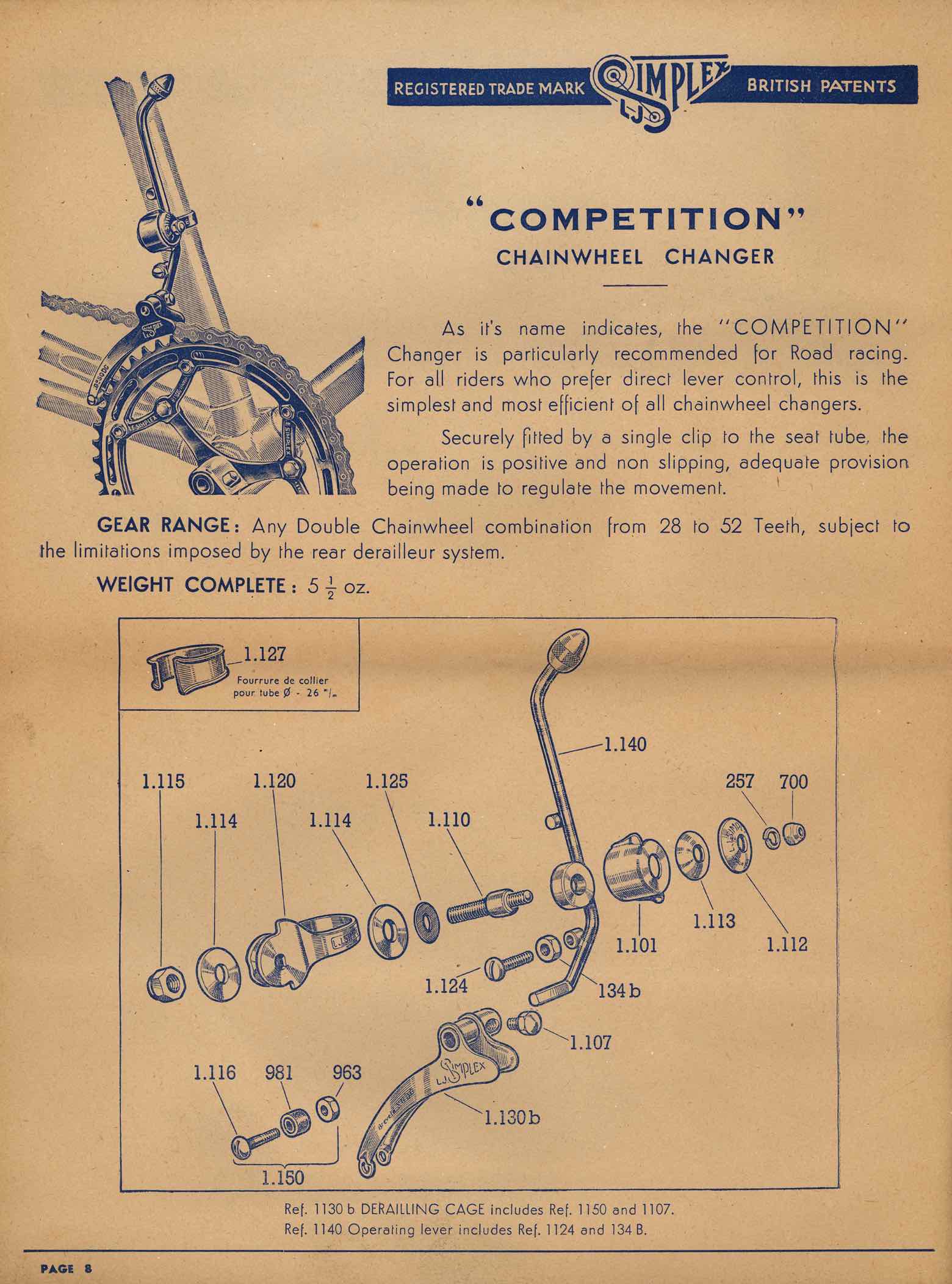

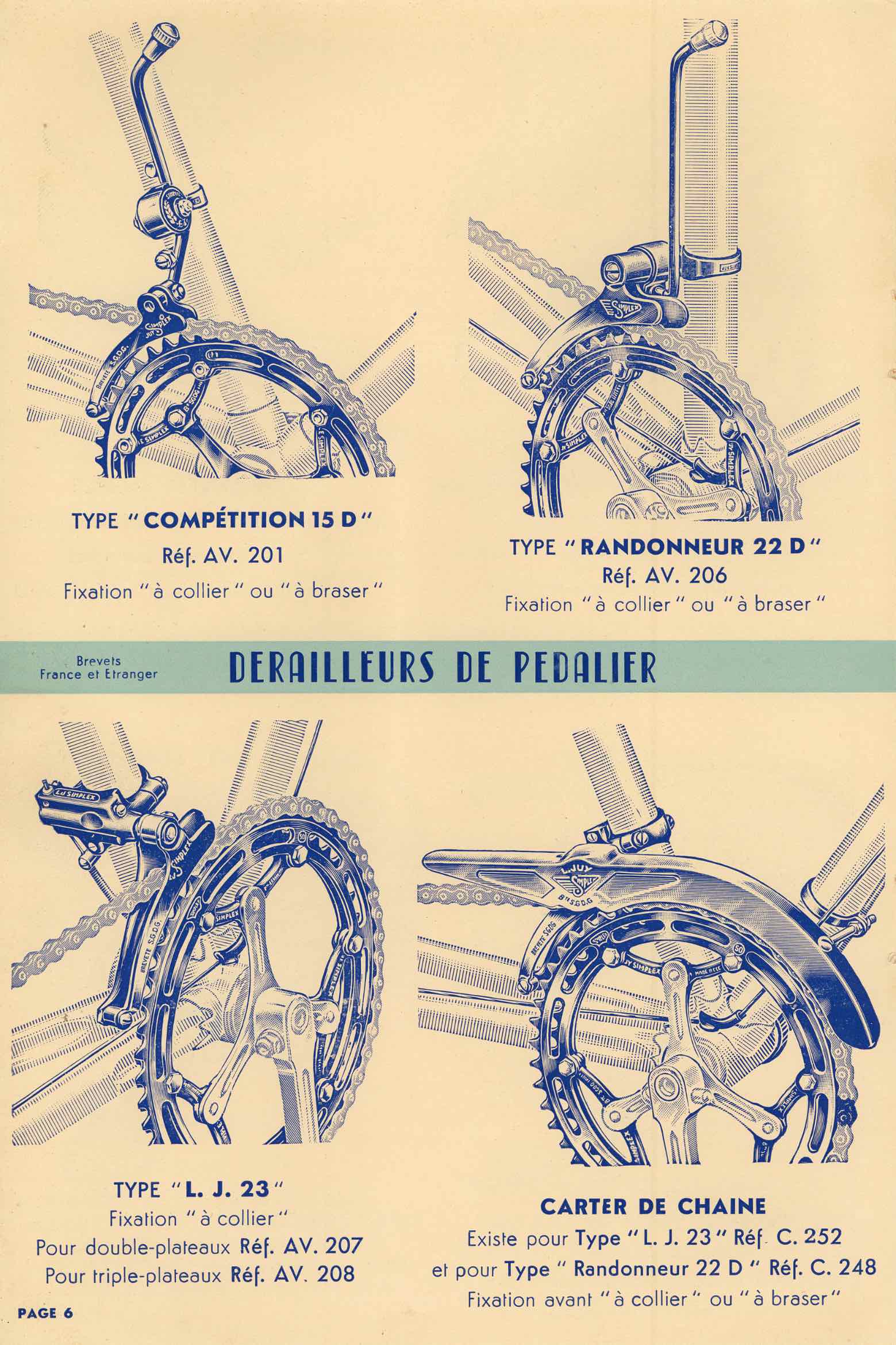

the companion front mech at this time may well have been one of the Juy manual ("suicide") front models such as the Competition or Randonneur serie

Since I have been summoned....
I think all evidence points to 'not a Paramount' but a serial number will likely be the only confirmation, (or french-threading).

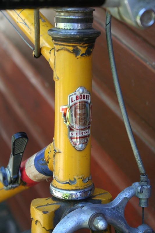

There were a few Paramounts in the 1950s with Simplex rear dropouts, but the other details don't agree (seat stay caps too long, headbadge hole locations, pump pegs, fork bend...). The double cable rear stop is a likely 'tell' as well (two of the Simplex-shod Paramounts have a single cable stop of a different style than this one). While Simplex made a double cable rear derailleur as Juvela accurately illustrates, there is also the Huret Special Tour de France Louison Bobet model, also from the 1950s (I believe the very first/prototype Campagnolo GS rear was a double-cable derailleur, but never in production). In fact, there were also Louison Bobet bikes (made in France by Mercier?), and some of the details on this frame look similar to this Louison Bobet bike: https://classiclightweights.net/france/louison-bobet/1955-louison-bobet-tour-de-france-bicycle/
Do check out this link...you may have your answer (note that the serial number on the Louison Bobet is stamped into the headbadge, so if there is no serial number on the frame this would lead one to believe...).

thanks so much for your usual outstanding information! ; ^. ]]]
am thinking this is about as far as we can go with the information provided by the OP's photos...
unless they hear back from seller with additional data
assuming until information to the contrary that tubing diameters & threading shall turn out to be metric
The chatter on this Frame ID has died off but if the OP has any updated info, it helps to fine-tune our abilities to ID unknowns. Also, not highlighted earlier, but it appears the frameset might have parts of an early/rare Campagnolo Gran Sport headset, with the engraved spacer (not a Super Record spacer) and the domed top nut...possibly also the bottom cup. The top cup is a later Record version. If the supposition that it is a French frame is correct, then likely a French-threaded headset (not as desirable, generally, but still hard to find).
