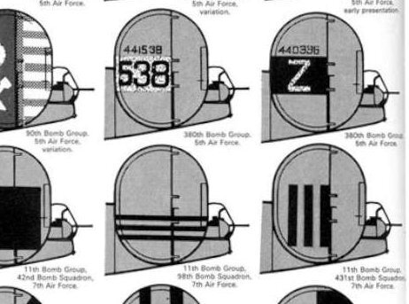

I am no guru on WWII aviation but the three horizontal lines as a tac marking could match those used by the 11th bomb group?
Once again I am spitballing but with markings so clear it would be great to find the history of your bike!
Aaron
