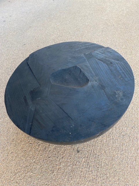

Sorry for not responding earlier as I had not pictorially documented my fabrication process in the past but I had the need recently to make some more hand grips from the vulcanite plastic center of an old bowling ball.
The sequence of the photos will give you somewhat of an idea of the fabrication process (sawing the bowling ball in half on a band saw (using an attached side support plate for anyone's safety during this operation) as I have discussed in my first reply to this post then shaping the cut pieces mounted in a four jaw chuck at one end and a live center at the other end on a metal lathe to the correct profile, length and bore. Some fabrication steps did not unfortunately get photographed but the main idea is to saw the bowling ball in square oversized lengths then go to the metal lathe to profile to size and sand and polish. For the polishing process, an internal stub mandrel can be make to hold the grip so the entire outside length can be polished.
Again, this is a messy and stinky job (if you have ever smelled old original high wheel / hard tire safety vulcanite hand grips) but the finished product outweighs the effort if you like machining or making things.
Hope you all like this.
Mike Cates, CA.
