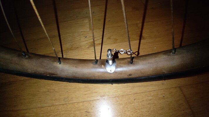

I absolutely love these G&J rims on my 1901 Rambler. They are solid wood and seem quite rigid - a lot thicker than the normal tube tire rims.
Since there is no metal clad to withstand the sideways forces of thed clincher tire, it is a good thing they designed them that solid.
I guess the doubel-bead profile of the G&J was supposed to devide the forces acting upon the shoulder (?).

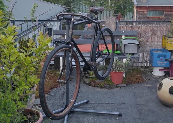

Anyways, I could mount the Rubenas without any modification - although I helped a little bit with a plastic tire mountig aid and (in some areas) silicon spray to press the bead snug into the rim profile before inflating the tube.
So overall a very nice experience.

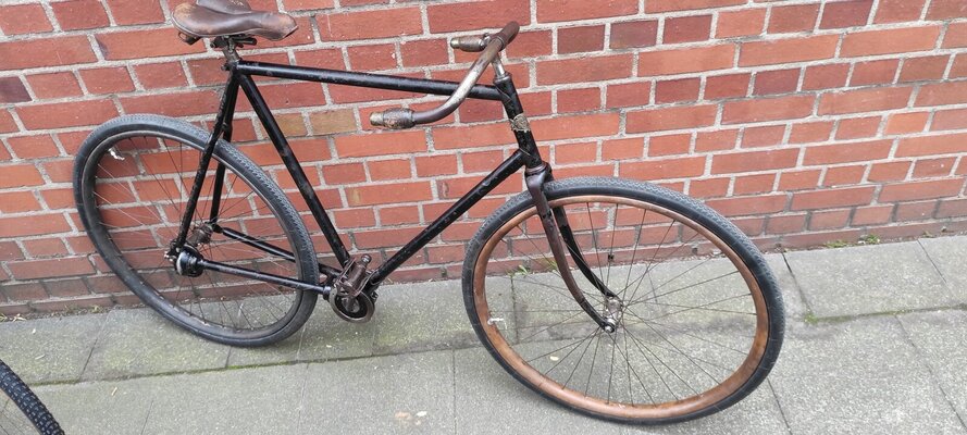

In terms of the color missmatch:
I assume the rear rim is original (black with thin golden stripes, like catalog states) and the front one is a replacement - still G&J, same shape etc. - but there are no traces of black on the front rim.

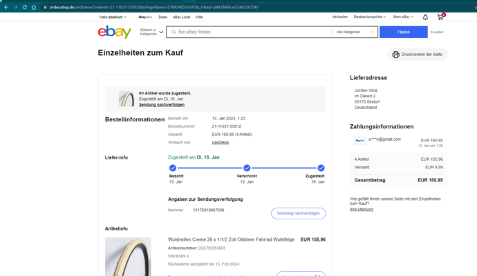

While browsing for something else - these came up:
I ordered two pairs
and here they are:
In WHITE :) - the kind which seemed to be extinct ...
Since they werent available for well over two years I imagined that red or brown or black ones might arrive ... but they are the real deal, light creme/beige :)
I didn't talk to the seller (German Bike Shop) but I'm guessing it is old stock.
Here ist the link
unfortunalty only 6 more are left :(
Yes, they have been a available from Classic Cycles in Germany for a few months now.
We have all ordered our lifetime supplies, hence the reason, there maybe only six pairs left?
