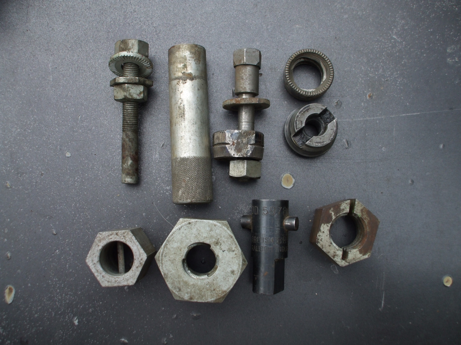

A box-lot of old rear coaster hub tools, literally it was all in a little card box at an old bicycle shop, and the owner did not recognize what they were for so let me take them along with some old hub bearings he sold to me. Obviously a lot of them are for working on old coaster hubs. The black one is marked "Britool" and "Raleigh", so maybe it is for Sturmey Archer, and a lot of them have the Acme type internal thread for working on the clutch screw of a coaster brake, but I don't know what all of them are so maybe someone here recognizes some or all of them. The two in the upper-left seem to go together, as the thing with knurling has a hole through lengthwise that the thing to the left of it fits very well. Thank-you

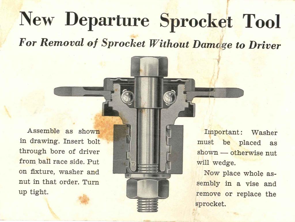

Well I found out that the second one on the top row may be a New Departure tool for holding brake disks aligned during assembly.
Yes #2 is a disc alignment tool.
#3 goes with the last one bottom right, they were made for different driver threads, New Departure Morrow Etc
1, looks like a broken front axle.
2 and 2.1 I believe make up the tool in the second post.
3. looks like a Morrow hub too
4 looks like a Muscleman hub tool.
I might have 3 and 4 backwards.
X, is just hub parts.
