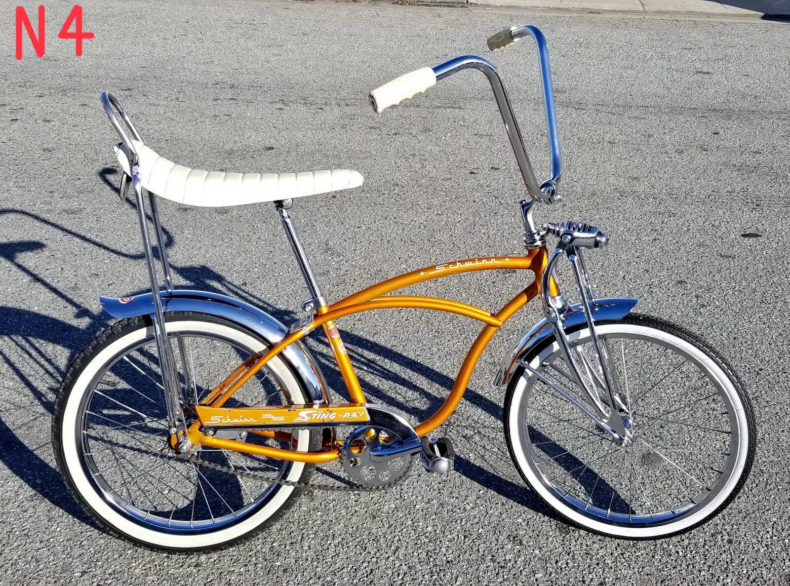

Does this N4 Coppertone look like what you remember?

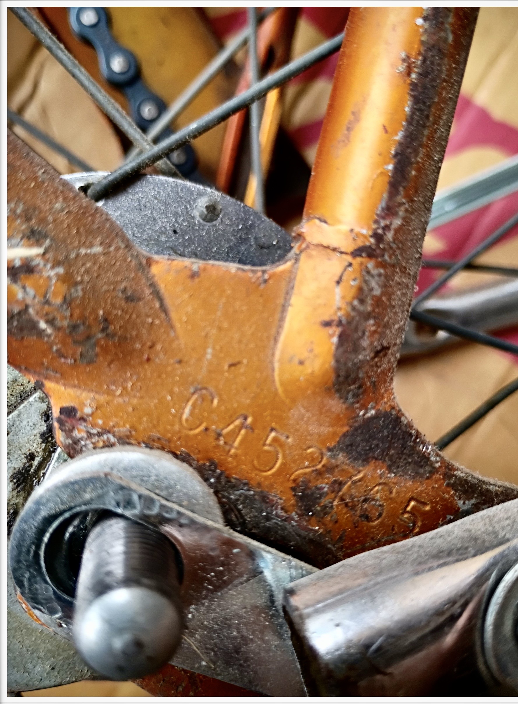

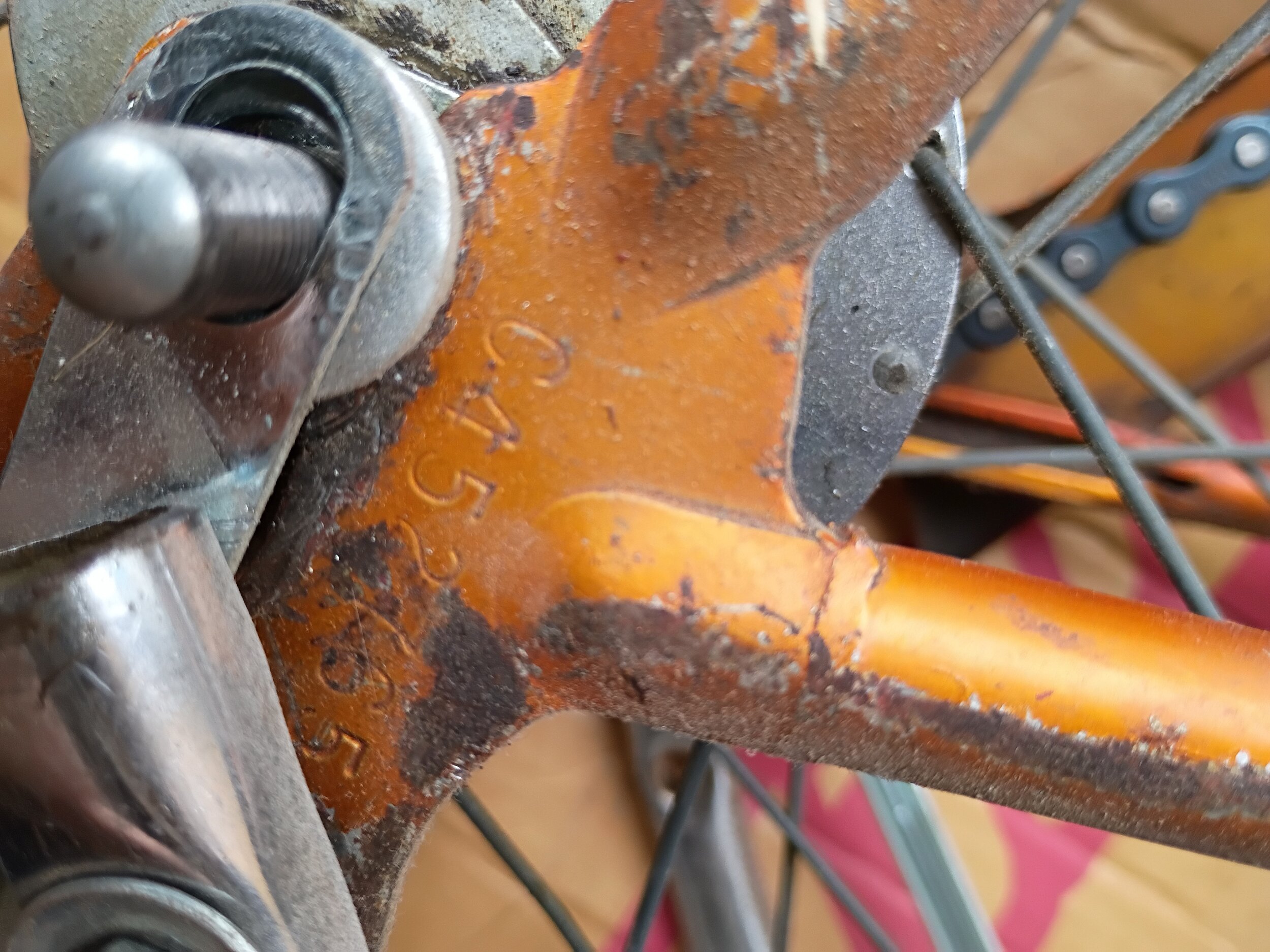

Please provide the first two characters in the serial number so we know what bike you’re dealing with.
I guess that would be accurate, even though it's not what I remember. My recollection is gold glitter grips and a gold sparkle seat, put my recollection in that Michael Jackson had very dark skin too, and I was clearly wrong about that.
The C4 says it’s a March 1964 (short frame) bike.
Schwinn did not make a Super Deluxe Stingray until June of ‘64.
Also the 3 Blueband Overdrive rear hub was not offered until very late ‘64 as it was a New Option for 1965 Stingrays.
Sounds like you may have had a J-38 Standard or a J-39 Deluxe that had a springer, rear wheel and glitter grips installed at one time.

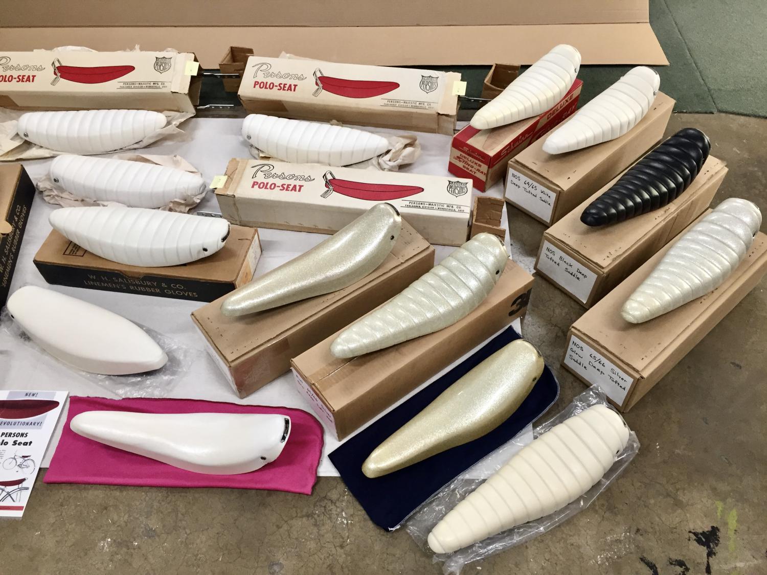

There are a few vendors that reupholster, restore depending on what you are looking to have done. Most want your pan or core to redo and yes, they look very close to original when done.
Here are some early Persons seat examples ...
My brothers and I were always taking things apart and putting them back together, so it's quite possible that I ended up with the wrong frame. Judging from what's here, it would appear that this is probably a 1966. The correct seat for that would be tufted silver glow, right? And is that more of a metal flake silver?
