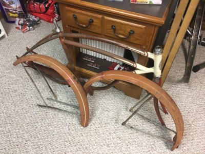

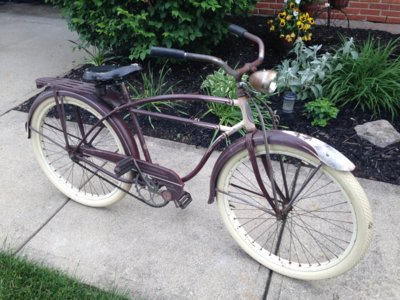

I agree 90% of the time to not clear them............but have done it to 2 bikes.
The first one is a 52 Hornet that my son and I bought as a winter project. It was totally covered in nasty crusty rust.......it took a long time using naval jelly and then various grades of steel wool and WD40. We stopped at a point where it looked good and did satin clear coat.......not matte which is almost flat.
The other bike I actually just did with satin a month or so back. My son wanted something kool for his college bike.
We picked up a 51 Hornet here on the CABE and did satin on it since the bike would be sitting outside in a rack in the weather.
He found out bikes were getting swiped and didn't want to take the chance..........so we kept it ( actually 4 sale on CABE ) here.
Honestly unless I told you it was satin cleared I doubt most would even notice. Pic without fenders no clear....next is as I got it / taken apart.
Did the 0000 steel wool / WD40 which made the non- original to bike fenders match much better....last sidewalk pic is satin cleared.
