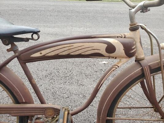

Posting up for help............thinking a 1937 but see where other info say late 40's and even 50's which I highly doubt.
Serial number is R56320 on a Schwinn Packard badged DX I just picked up..............will post up in Sunday Finds thread tomorrow.
Thoughts on actual year from the pros? I'm not sure which info to believe but betting / hoping 193 1472615

Very cool dx! I'm pretty sure you've got a nice early postwar bike there.
