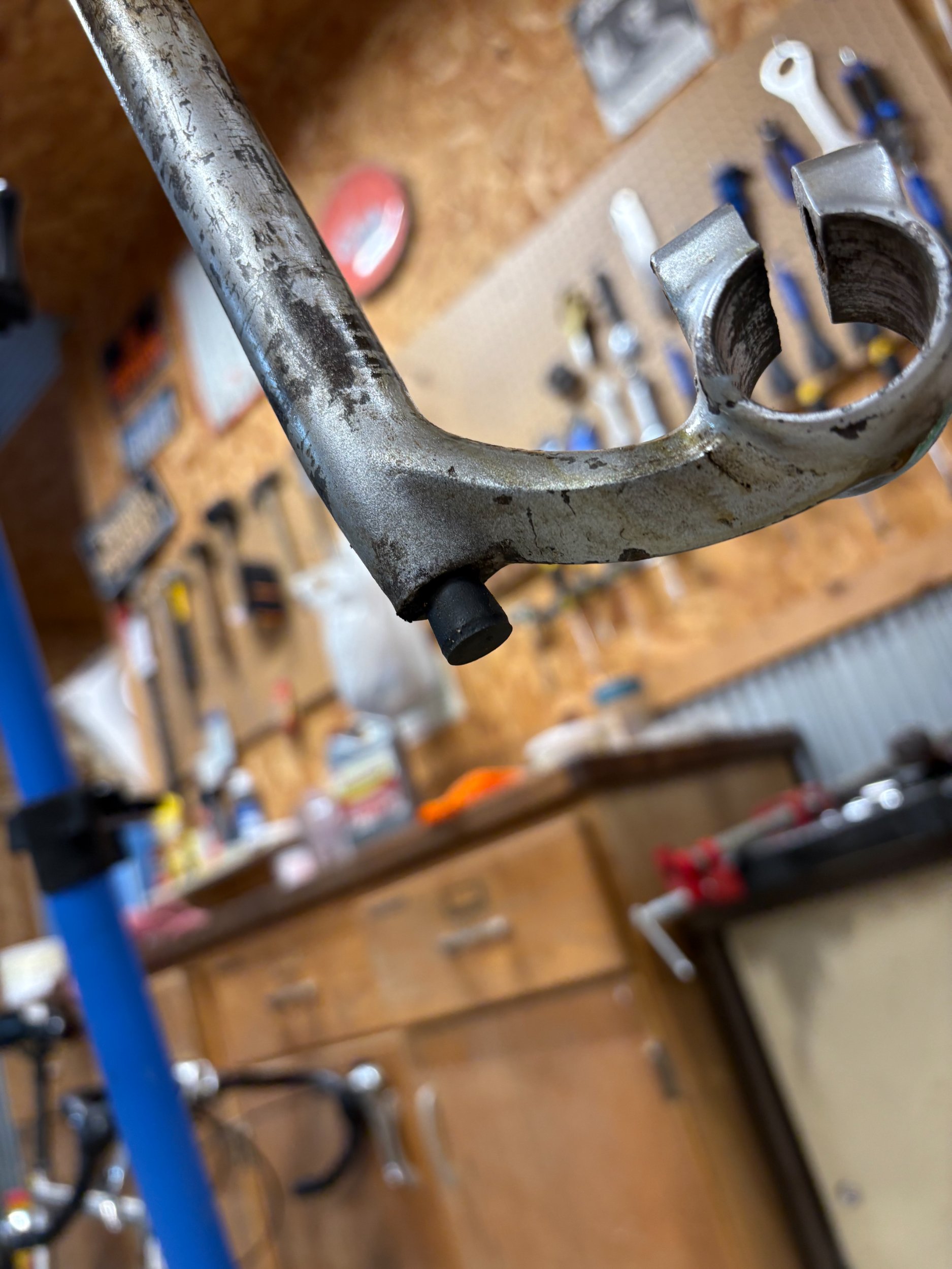

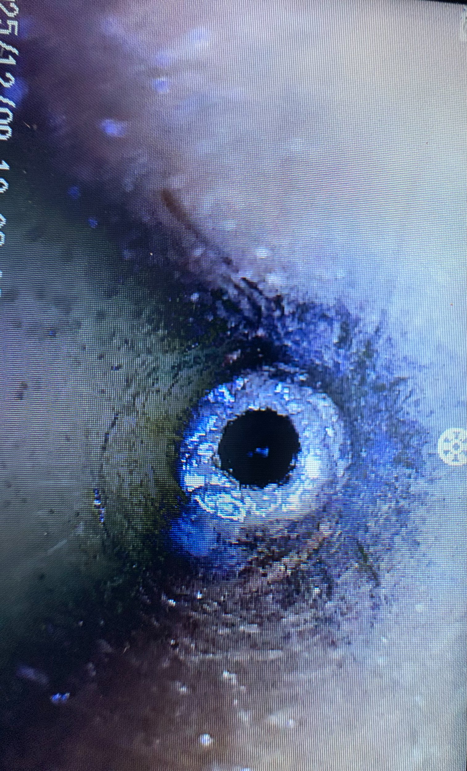

I am new to the site and still navigating my way around so if this isn't the right spot to dig further into this issue, let me know. I have a 1939 cycletruck I am working on restoring. I am having a struggle separating the handlebar stem from the fork. The bolt that goes down to the razor piece has been missing for decades and the razor piece has rusted to the stem. I put a borescope down the hole where the bolt goes to see what I was dealing with and have attached a picture. Curious what others have done to loosen stems. I've tried copious amounts of various penetrating oils and some heat but not to any extremes yet. The frame is currently at a friends who runs an auto repair shop. He has a convective heater coil and ratcheting tools which is my next step.

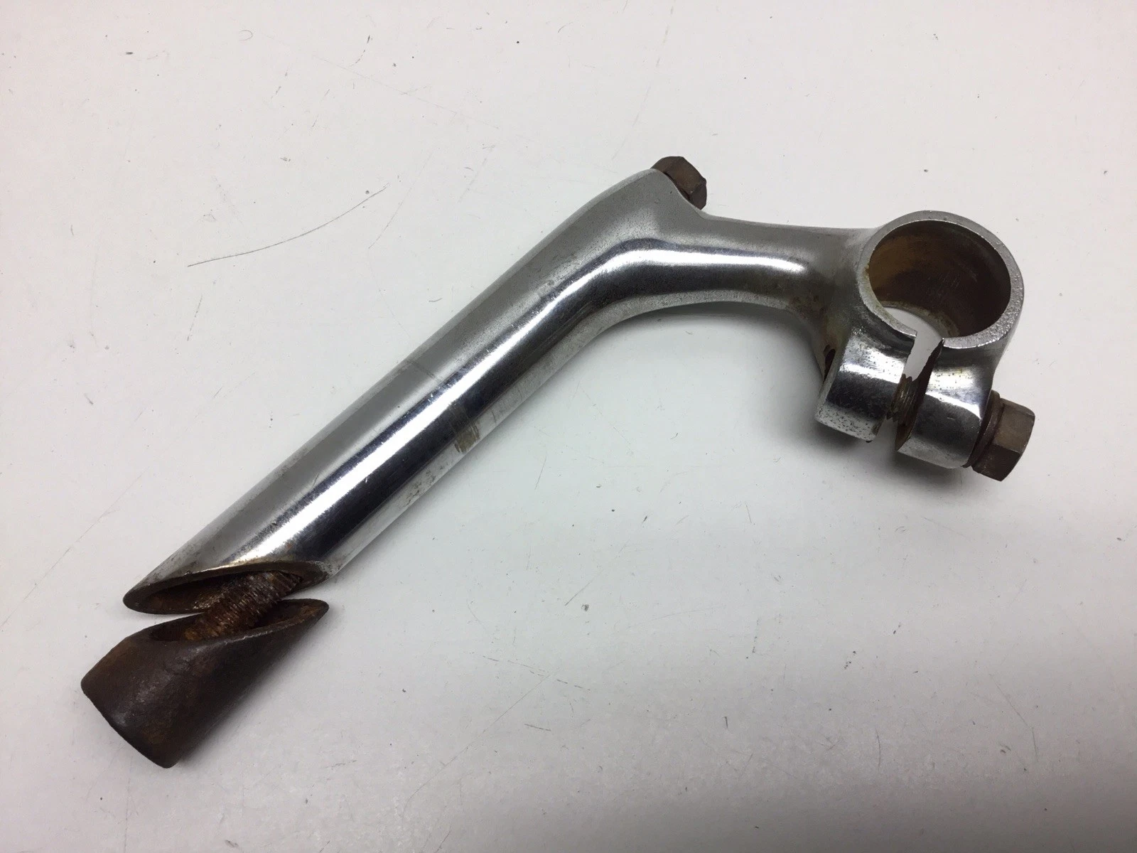

Here are a couple to show you what they look like and what holds them in the fork. You can't just loosen or remove the bolt, the wedge needs to be tapped down after the bolt is loosened. Normal practice is untread the bolt maybe three threads and then tap the bolt down. Try to twist the bars. Loosen the bolt a little more and tap it down. this drives the wedge down. If after repeated attempts is when it gets fun if nothing moves.
Here's how to start when removing a stem. You'll be lucky if nothing is bound or rusted up.
Thanks for the reply. Well, I guess I did know how to remove it but I never assume anything especially when I'm trying to free up a 86 year old part. I might not have given all the details on this thread but the bolt is gone. Been missing since I can remember. and somehow the bike seemed to not need it. Probably because at some point the wedge piece rusted to the stem? That's the only explanation I can think of based on what I can see with the borescope and how frozen it is. My dad did some clean up on it sometime in the early 80's I believe. He painted it Aeronca yellow (leftover cowling paint from restoring his 1944 L-3 Defender WW2 observation plane. A lot of things in his shop were painted Aeronca yellow ). He sprayed the handlebars with silver paint and I'm assuming somehow in that project the bolt didn't get reattached. We did try after soaking it with various penetrating oils to stick a 5/16" rod into the shaft and try to tap on it to get it to loosen with no results.

That's the last stuck stem that I dealt with. If you can't tap the wedge down, yours may be suffering from the same situation where the wedge is bottomed against the step in the fork steer tube.

WW4P,
Thanks for the reply. On your note you said to post pictures of the entire bike and the steer tube. I did post a picture of it on the All things Schwinn portal on this site here is a shot of it again. I'm still a rookie on the site so I'm probably not the getting things perfect in relaying info. These were taken a few years ago at a bike event. The other shot already posted in this thread is a borescope down the tube where the bolt goes. It shows the end piece pretty much fused to the wall of the tube. What I am trying at the moment is soaking the entire tube in a rust remover product. I plugged the hole where the bolt goes. flipped the bike upside-down and poured the rust remover through the small hole in the top of the fork tube. I haven't kept track well but it takes 6 to 8 oz is my guess to fill it to the point where it backs up through tiny little drain hole so I'm assuming ( which always gets you in trouble) that the rust remover has filled everything inside the head tube and is going all the way to the fused spot where the bolt would go in on both sides so it should really be getting a soaking. I have pulled out the stopper and flushed out the solution a couple of times and there's a lot of muck coming out which you can see in the container on the floor. That's actually solution from the 2nd flush. # 1 was a real doozy. I'm now on number 3. I can't get any movement on the stem yet. I also have a very long Phillips screwdriver that I cut the head off that I've been using to go into the tube and rap on the area shown on the borescope picture. There was a suggestion that I get another bolt with the same thread pattern and try to into see if I can lodge but although I can't see the threads on the borescope picture, I did run an all thread down there past the fused point with no luck. As you would say, patience. I have no clue if this approach is a good one but from what I've seen including the link you posted, the MacGyver playbook is a big one.
