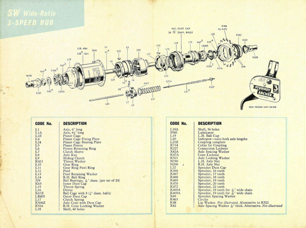

CHANGES IN THE STURMEY-ARCHER S-W HUB

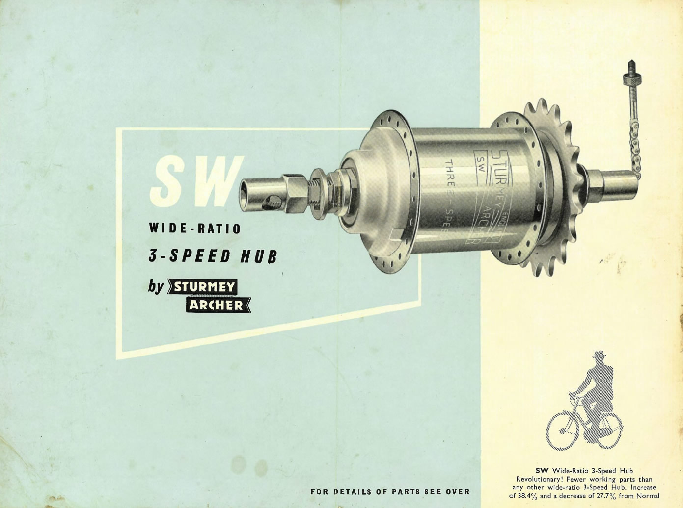

Acting in the wake of a considerable number of dealer requests, a number of changes have been made in the Sturmey-Archer S-W hub as now supplied or to be supplied in the near future. Here are the changes: A nut and a Bushing are now used to keep the planet carrier in place. This was formerly held in place by a spring washer which, if loosened up, did not allow the hub to be shifted. Secondly, a one piece indicator spindle will now be used. This will be used for the right side and will be adjusted by bringing the shoulder to the end of the axle while the hub is in "Normal Gear". This, of course, necessitates the change of some parts. The following are the changes and correct part numbers. OLD HUB WITH TWO LONG AXLE NUTS AND A SPLIT INDICATOR, NEW HUB (I have omitted the part numbers) and only listed the description, axle 6", axle 6 1/4", axle nut right, axle nut left, indicator rod left, indicator spindle right side, axle key. The new hub can, of course, be readily identified on a bicycle since it uses only one long nut. There will, however, be no chance for error since the new axle is not drilled through.
