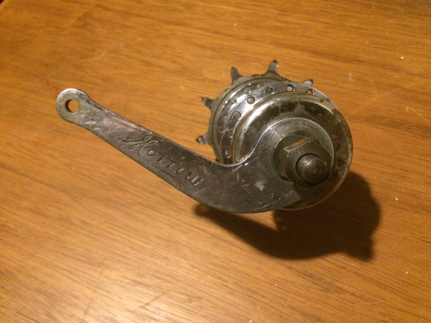

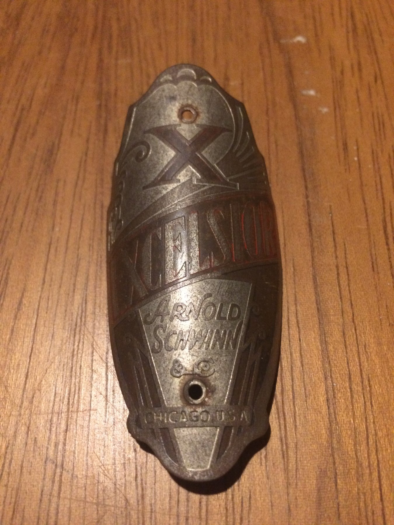

As I mentioned I have been collecting parts. I'm aware that these bikes came with a variety of headbadges, and since my bike didn't have one it really leaves only one choice for a klunker, Excelsior. The obiqutous Morrow hub has also landed, and a ridiculously long exerciser seat post. The crank/bb came from the same bike as the badge, supposedly a '37. I absolutely love old Schwinn's, but I can not stand the four leaf clover chain ring. I also want this bike to be more versatile (single track, etc.) than just ripping downhill, so I needed better/shorter gearing. I was on the lookout for a child's 18t chain ring, and this is what I recently found. Not sure what it is from, but it's reasonably good looking and will get the gearing (1.8:1) where I need it to be.
As you can see the plan is very traditional mid 70's, but making it a better all around mountain bike will warrant a few changes, I'd love to hear your suggestions. The chainring is of course one. A Brooks B72 was the saddle of choice back in the day, but there's no way I could pedal for very long with that Lay-Z-Boy under me. So I'll need a slightly narrower Brooks, hopefully still sprung? The huge cruiser bars will also be a no-go, but I'm not really sure what will work. I want something much narrower, and period correct. Pedals with more grip as well. Vintage BMX?? I imagine I suppose I'll try to find an original stem and front hub, or should I go high flange? The hardest part to track down will be an original prewar fork with truss rods. I've been looking for months with zero luck....
