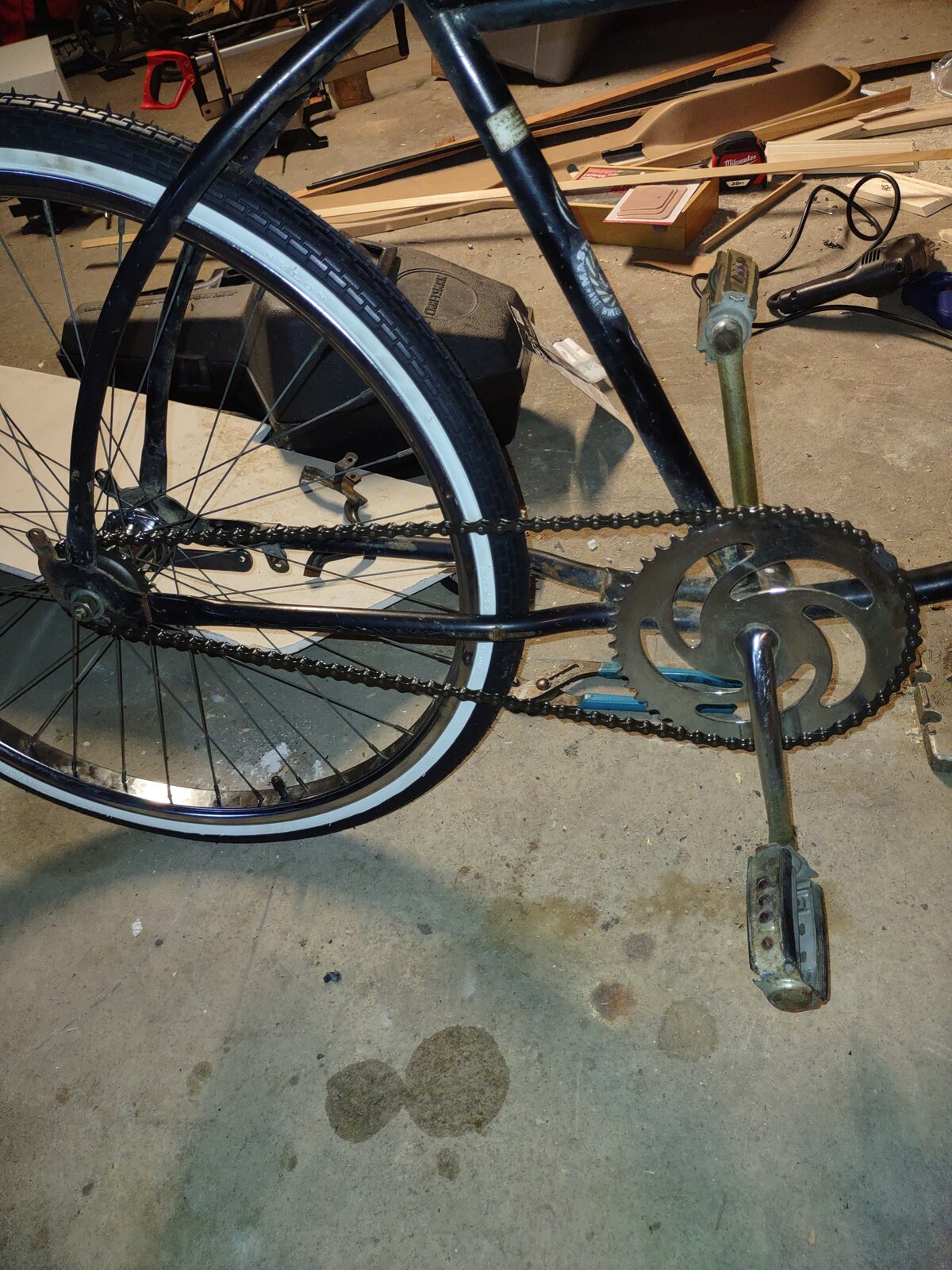

Finally got the tires on and I am still working on the front fender still as well as a new chain. so far so good . I can't wait for more parts to come in. View attachment 1435851
Don't mind the grease on the tire me and my grease gun had a fight .
Also if anyone has a lead on someone selling the correct cargo rack let me know.
This is one nice old Roadmaster... I need to know if you have a rear fender coming? I might have one if you need one. Good looking bike so far. Enjoy and RideOn. Razin.
Oilit is supposed to sell me the chain guard and the rear fender when he heads up to my for another bike but if for some reason that falls though I will let you know still need the rear rack but I might have to run it with out for now lol.
I had to go with duros 26 1.75 no bike shop in my area has any white walls and they are a few months out for ordering . Eventually I will get American made tires but they do look good .
