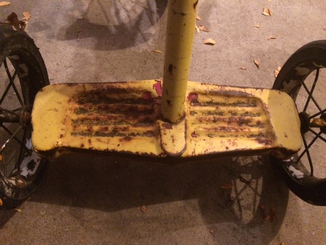

    Hi Raphael, and welcome to the CABE! Could you possibly get a rear photo that shows the step plate clearly? When there's no other markings, the design in that plate can many times identify the maker. I'm thinking this might be a Mercury or Midwest tricycle with the rain gutter style front fender, but the step plate design could make identification of it more accurate.

    Sorry, I had to be away from the computer for a few days. I am stumped on this one. The raingutter fender tells me it has to be a Merc or Midwest/MTD. The rear step plate looks more like Midwest than Mercury though I don't feel confident enough to say 100% for sure it is a Midwest. I see that yellow house paint is coming off in places to reveal red paint underneath. Perhaps you could carefully remove it from the head tube area to reveal part or all of the original head badge, if it wasn't removed before painting.

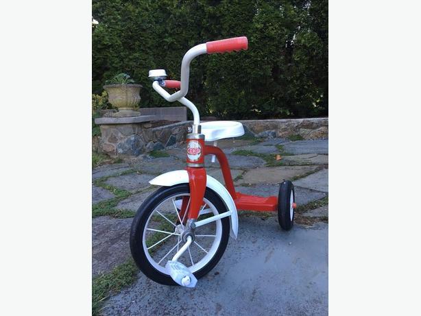

    I found a picture online that I think is an identical tricycle and it's an mercury. Do you know is it was restored to its original look? Were the handel bars and wheels originally painted white or the were chome? Also where could I get the correct head badge? TYVM!

    Looks like you found a pretty good match with the Merc! Here's a site that has replacement head badge decals for Mercury tricycles. Not sure which style was used on yours though I'd guess the rectangular one. As I mentioned, it might still be hidden under the yellow paint. I've never dealt with this site before but they seem to have a good selection of trike head badge decals - https://www.gocreativegraphics.com/tricycle-bicycle-decals-and-headbad
    Some trike models had painted handlebars and some were plated. Best place to remove the surface paint off the handlebar and check is at a grip end to see what's underneath. The plating under the grips usually fared better than plating that was always exposed and could have pitted and flaked off over the years. If you just have bare steel under the paint at the grips, it's a pretty good assumption the bar was no doubt originally painted white.
