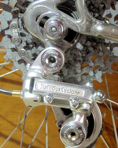

@Jesper - borrowing your photo
This is Not chrome-plated. There is no diamond or any other material in a wheel skewer, axle nut or RD bolt washer hard enough to mark chrome plate like that.
That has to be bare steel, except for where it's painted.

One would have a helluva time marking chrome with a grinder - chrome plate is Hard (70 HRC) - harder than steel can be hardened (50 HRC).
TX PE No. 75665
I'm a metallurgist with a professional engineering license.
Actually, it is chrome plated. It is not bare or polished steel. Verified by another who does plating and other services.
Another metallurgist told me that silica and certain oxides can cause scratches to chrome plating.
