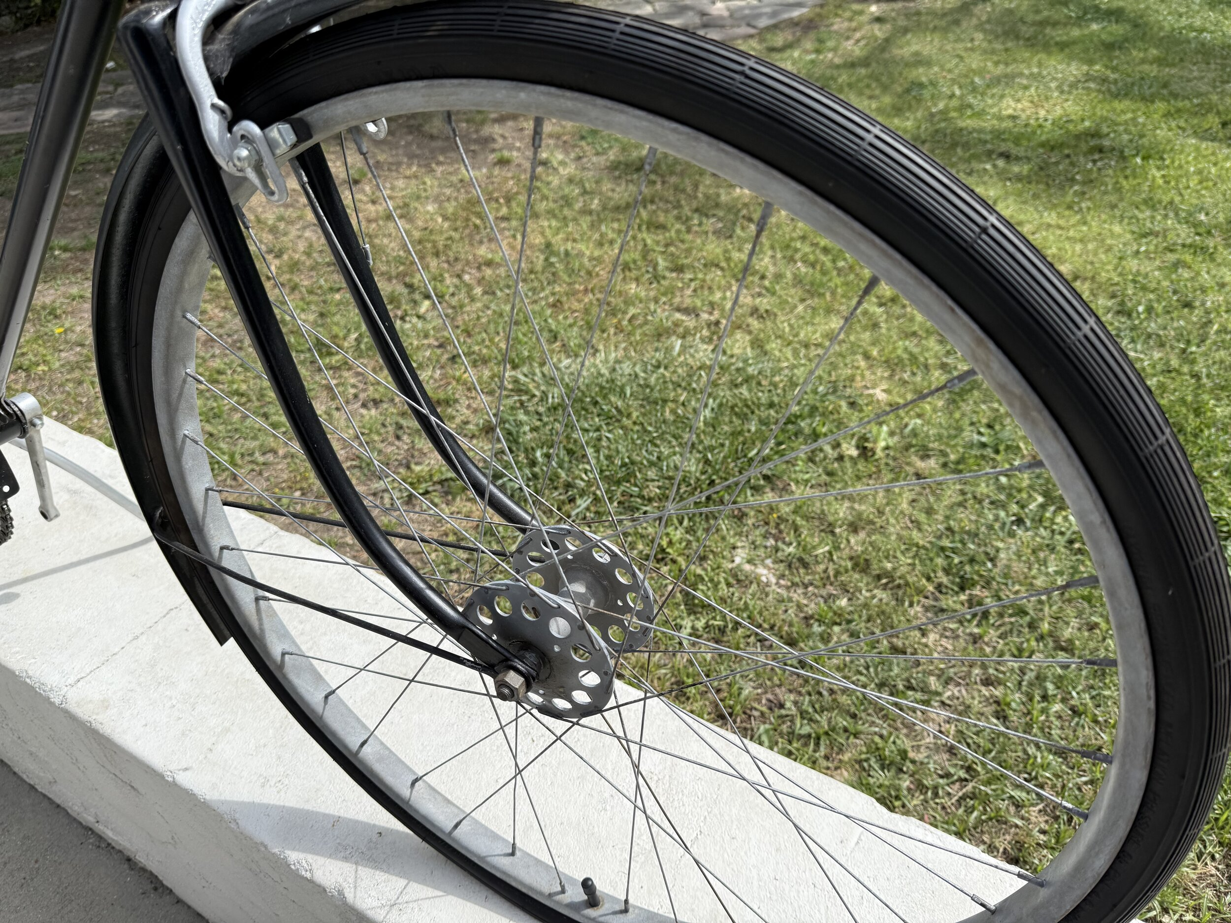

The prewar "wire" type brace is def a weak spot in the design. The pencil thin brace makes the mudguards look like they are floating, but the stress riser stamped center hole mass-produced fabrication method makes them weak. This is epecially a problem when they are unattached and the long arms transfer a lot of force on the weak spot. I 3D printed some supports that I used on the broken braces on my gramp's 41. Hard to believe that was 7 years ago.
