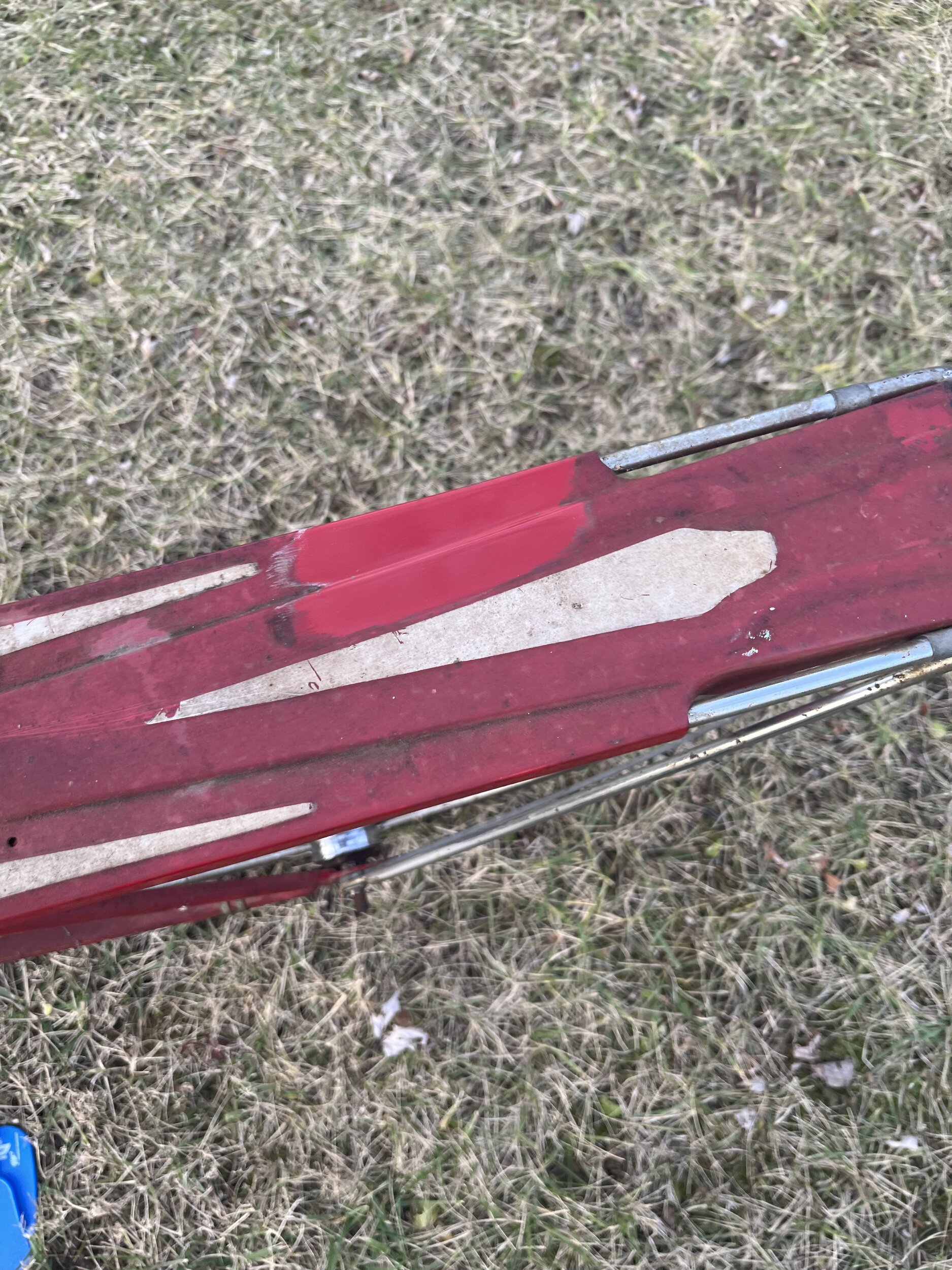

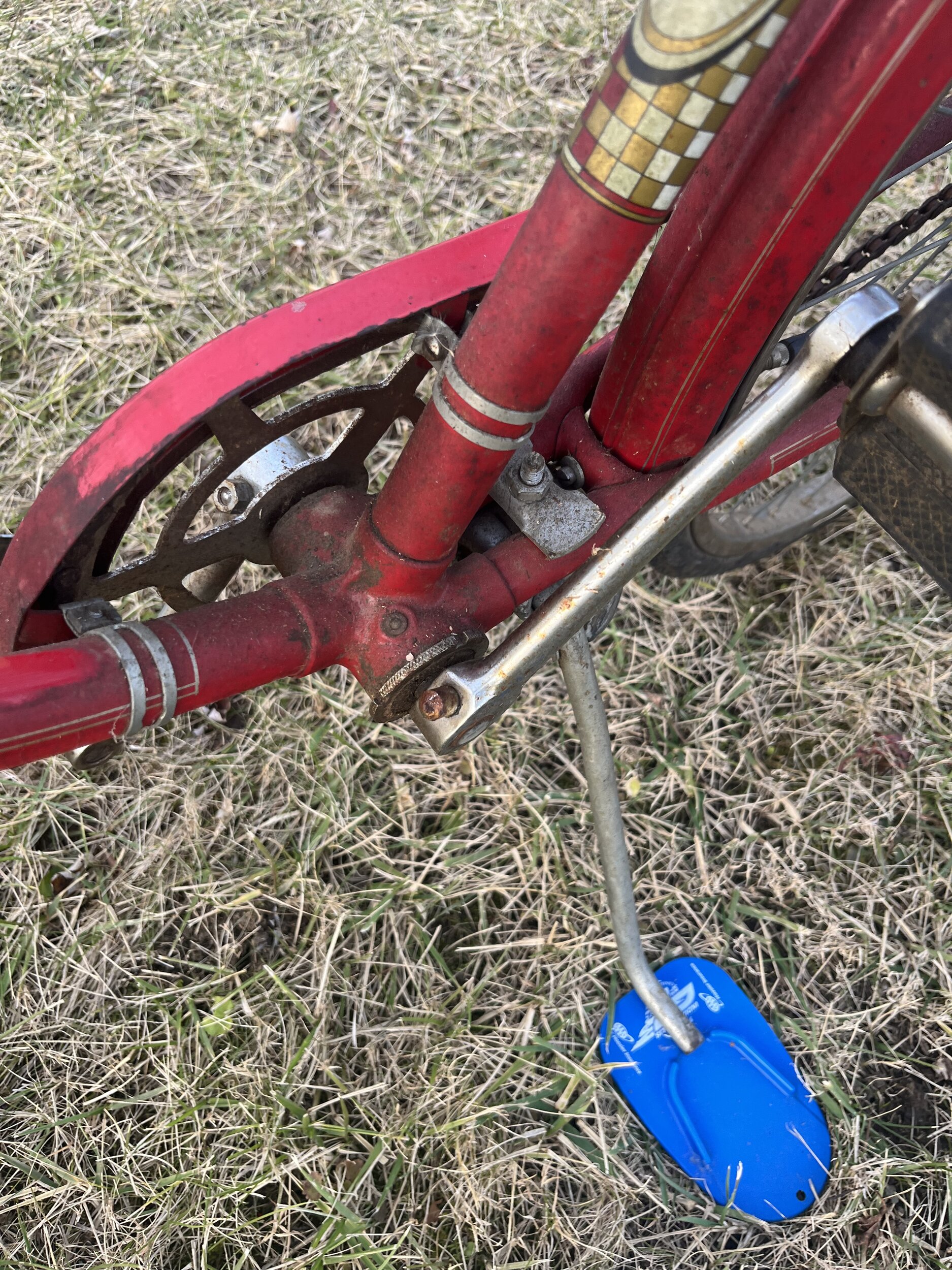

Just acquired this bike. Thinking a Norman made according to number on seat tube. Serial # is 9126NK. No name/date on the coaster hub. Maybe a ‘59? Currently covered in grime but from the pictures shows a nice red color. Seat is a Wrights. Tires are Bates Dunlop. Any help with dating and manufacturer would be appreciated. I know there are some British made experts. Thank you.
1959 about the final year for "Norman Normans"
the frame's lugs, bottom bracket shell & other bits appear to be from Brampton
there will be raised numbers on the underside of the bottom bracket shell which indicate the model of the shell from Brampton (not a serial)

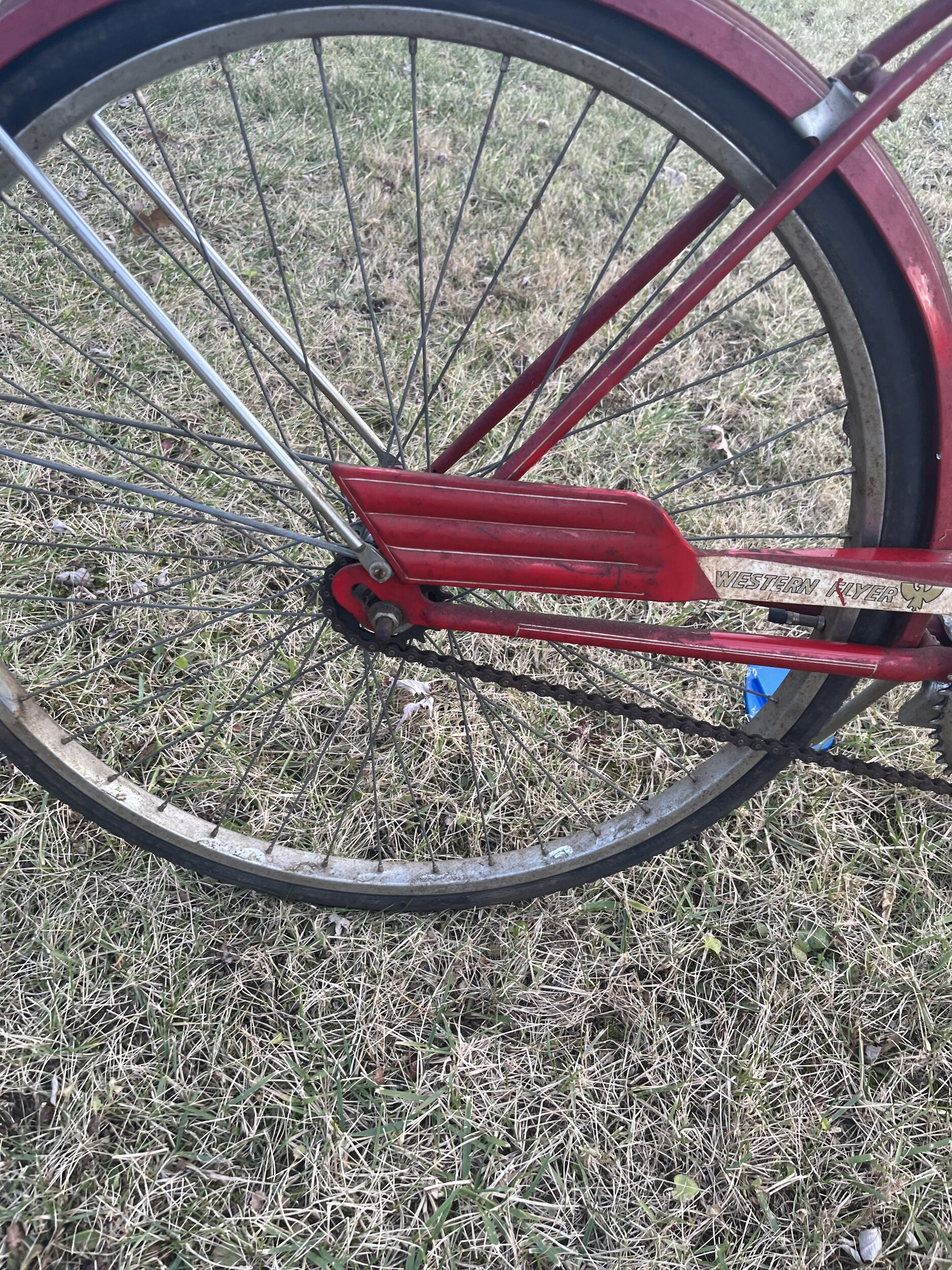

With that chainguard, my first thought was German, but I can see the "Made in England" decal on the downtube under the tank. There was a company called Raynal that made bikes with that chain guard, and there's one on Worthpoint with the frame like yours, but who or what "Raynal" was is beyond me.

the prominent "fin" on the chainguard places the cycle in that era when automobiles were styled with "fins"

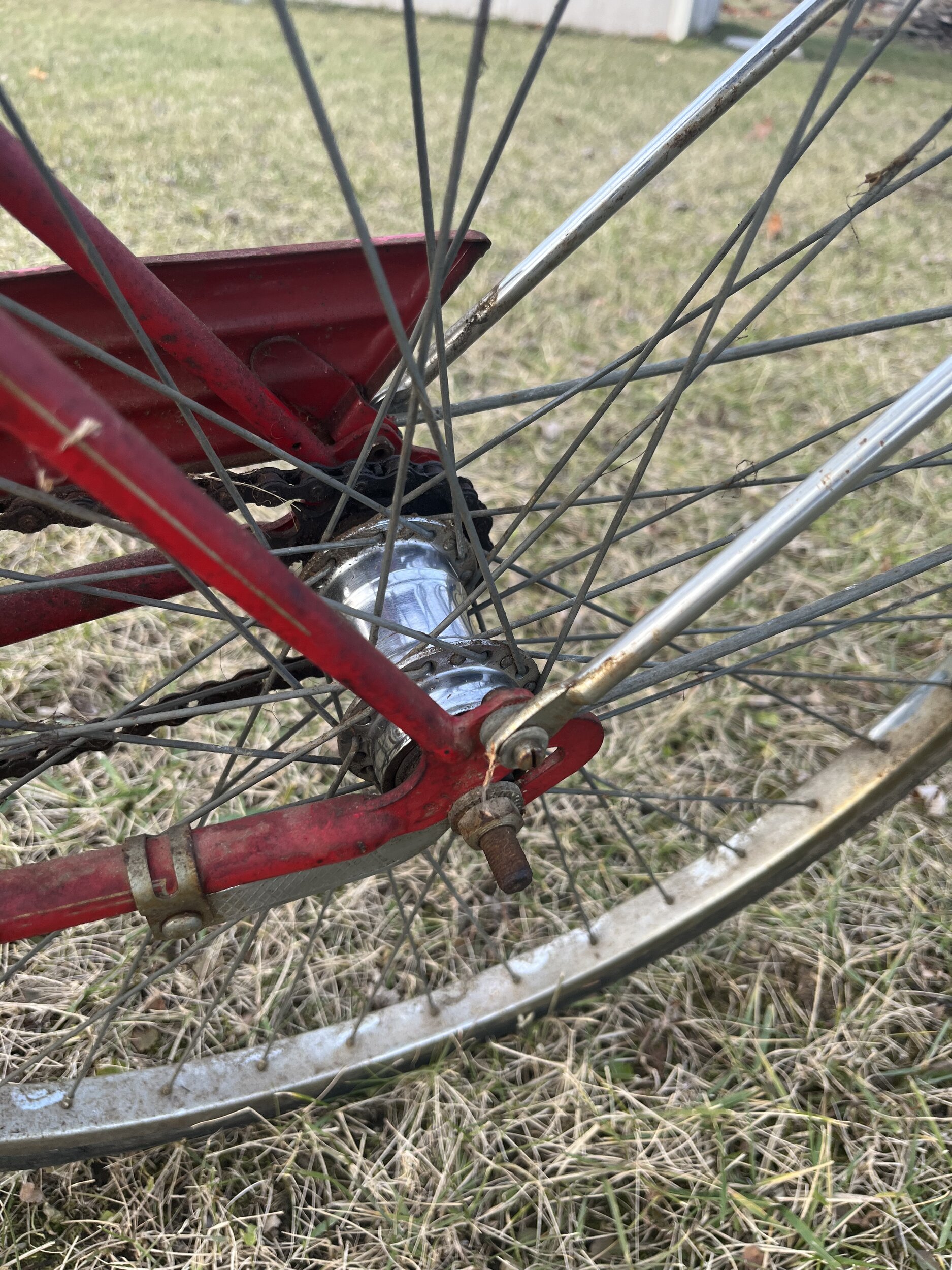

Rear hub marked with an A only. Ball bearing oiler. Any idea on maker?
any marking on arm?
if hub a F&S product the letter A would indicate a date of 1958 which would fit right in
