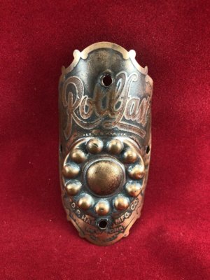

MCI head badge and a 6-H DP Harris New York City Rollfast chain ring; Snyder bought into the Excelsior company in the early 1930’s. If the chain ring has 24 teeth, it may have been swapped for a 26. Rollfast called theirs a “sport motobike”.

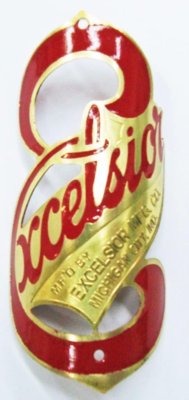

How many head badge holes are there, 4; (might be easier to see on a real computer)? The accent dart paint looks like the more deluxe style, often furnished with "Rollfast" head badges, in the greater "Rollfast" product line by DP Harris. The white behind the head badge makes it look like the Excelsior badge has been there for quite some while. Does the seat mast tube (front) have any additional labelling?
Tyberius
Aug 13, 2018
53
46
Annapolis MD
2 holes, no additional markings or numbers on the seat tube.
Sorry for slow reply. 2 hole badge, nothing else on seat tube except part of this decal (see photo).
Looks like the Rollfast Model, and in a darker Burgundy Red color.
http://www.nostalgic.net/bicycle194/picture660
Similar to the Deluxe, (less tank).
Also, looks like a New York badge was swapped-out for the Indiana (or Indonesian?) head badge.
Is a probably good thing that extra holes were not drilled into the head badge, to try to fit the existing holes in the frame.

Almost back together...so the 2nd and 3rd pictures convince me that this was not re-badged. I took apart the bottom bracket at it was a real hodge podge of parts. 2 different bearing manufacturers. I'm thinking that the chainring and possibly crank might not be original. If it isn't a Harris bicycle, what kind of chain ring would this have had? I have a period-correct but possibly not model correct lower end in the mail to me but I only want to re-asseble this once.
