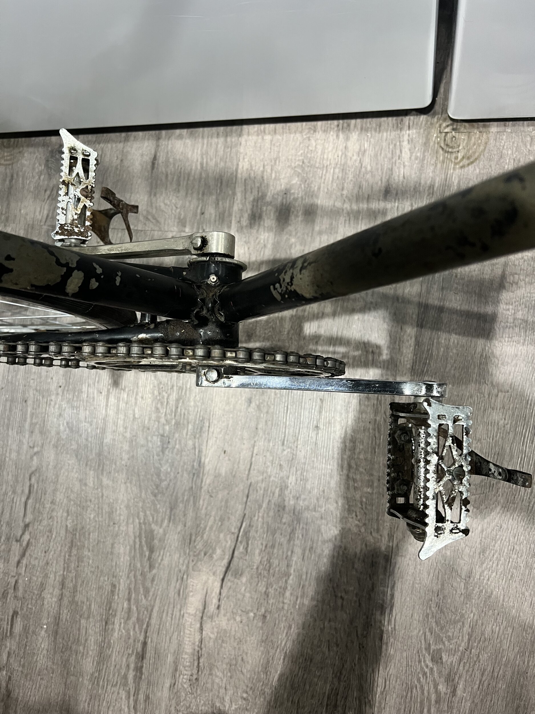

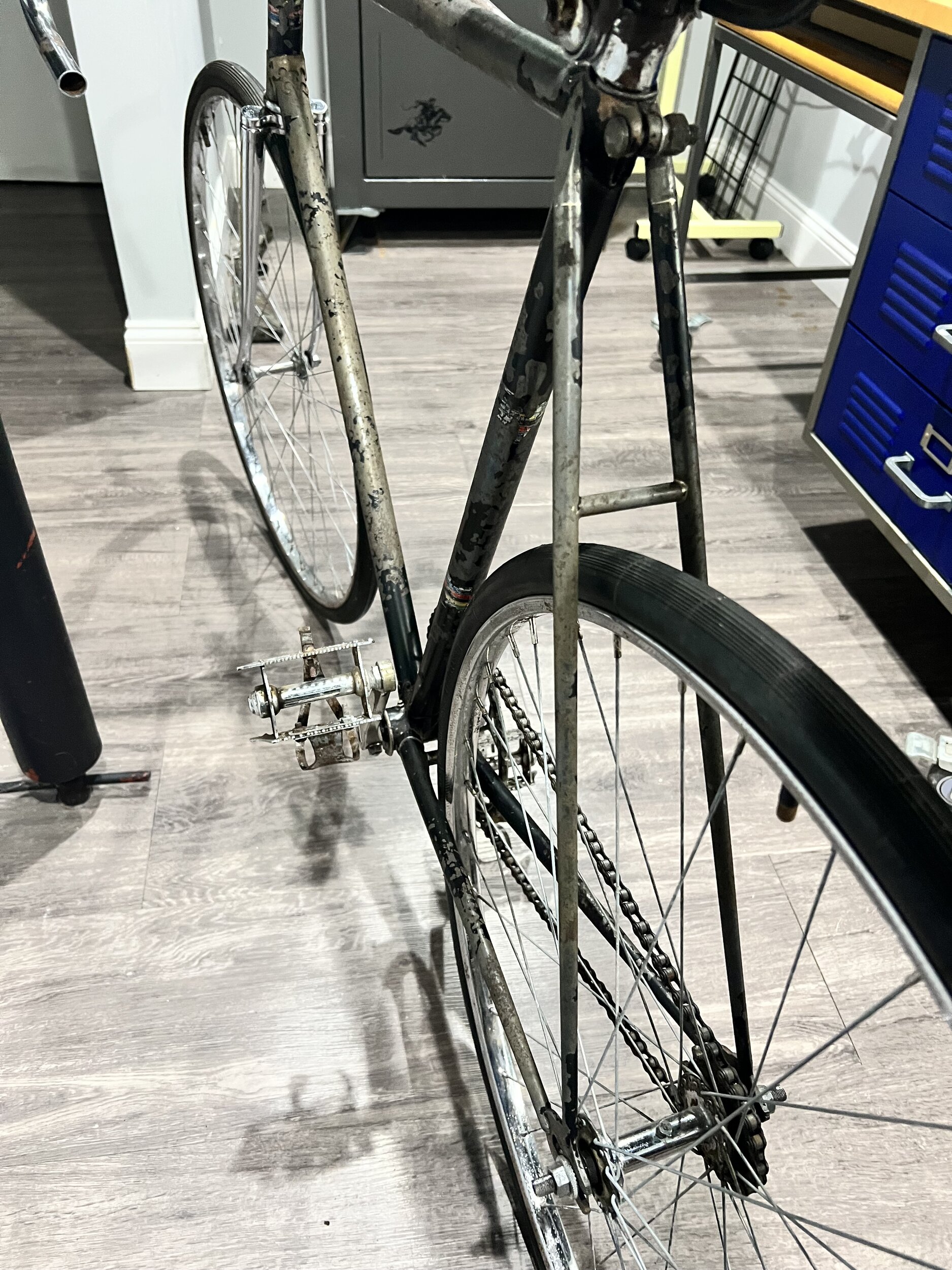

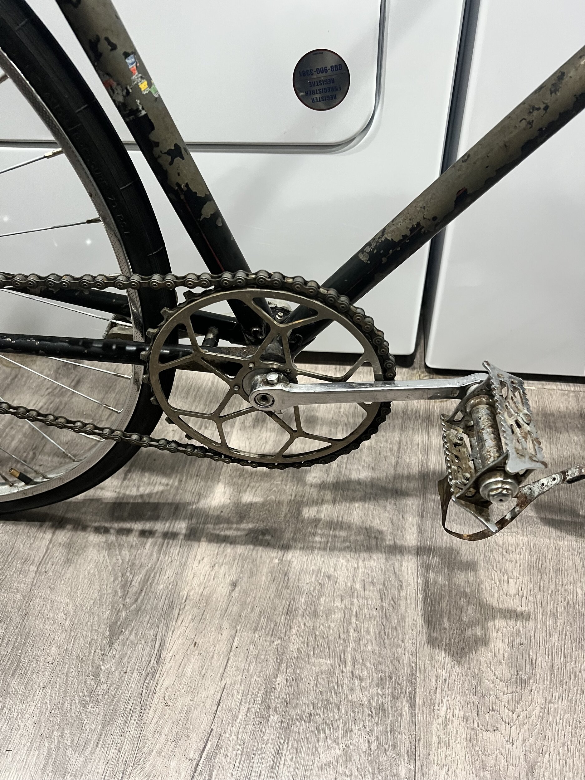

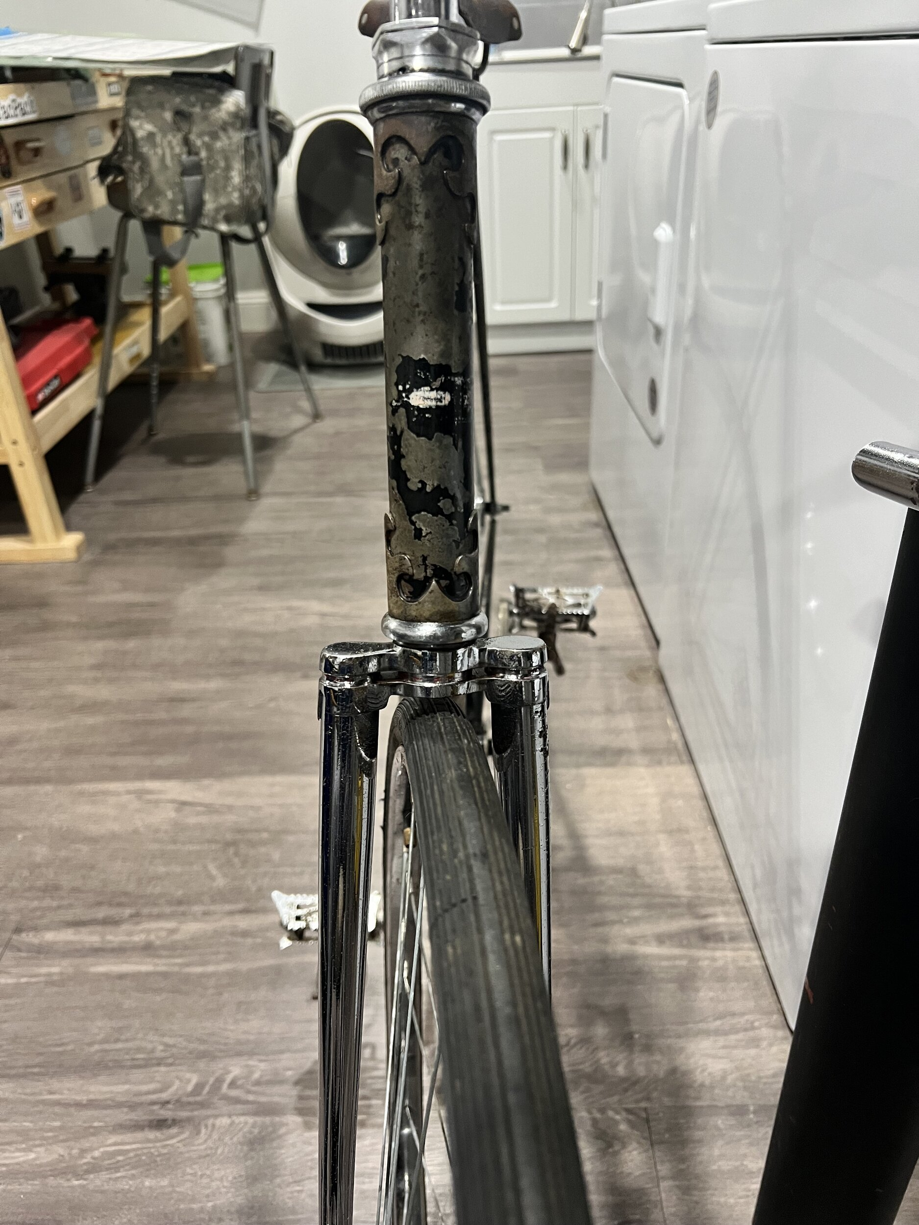

This post is an update regarding a fixed gear track bike I posted a few weeks/months ago.
The pictures that follow show the results of the initial cleaning and rust removal. I have tried to get some of the finer details of the bike including the silver welds in the rear triangle, maker marks on the rims, hubs, and on the adjustable stem.
I have also tried to capture the details of the fork crown, lugs, and headset.

Additional research leads me to believe the frame was built by Richard (Dick) Powers.
He hand built bikes in his shop in Sunnyside Queens NY. Apparently he used silver to weld his lugs because it allowed the tubes to maintain straight line rigidity.

Pics
Nice old bike.
On any bike with a three piece "cottered" crank set the crank cotter pins need to be installed in opposing directions. Doing so, will keep both the right and left crank arms in a straight line.
John

Curious, what is that piece do next to the cabinet, behind the bike?
Silver melts at a lower temperature than Brass which lends itself to building with thinner tubing and has a smaller heat affected zone which helps maintain that rigidity.
Clearly you did not see the before pics. When giving new life to an old bike sacrifices need to be made in order to preserve the beauty and splendor of a vintage Pista.
I saw the bike before and you were advised not to overclean it. To rub the Powers headtube transfer and most of the pin strips off the bike is criminal. You should not have touched the frame.
