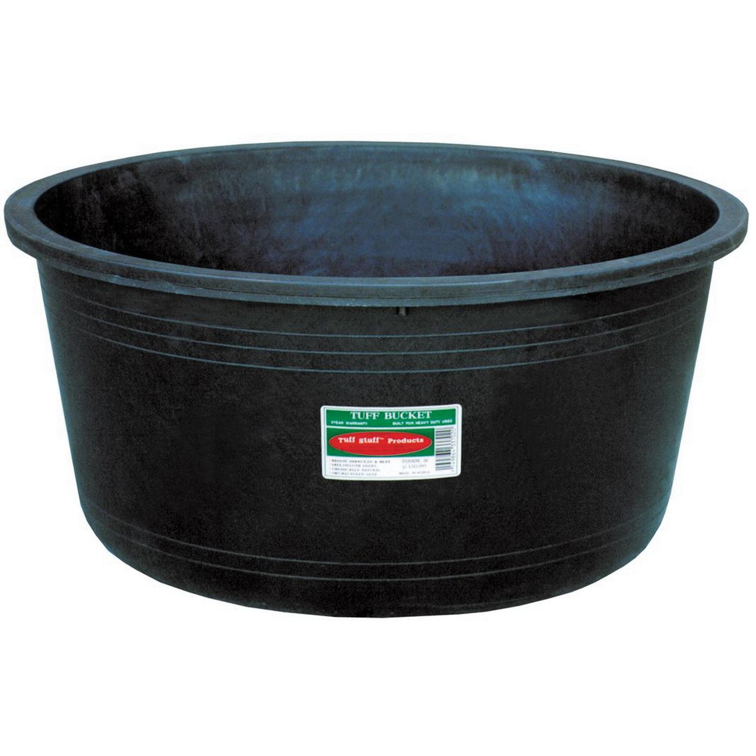

Just found this, also:
TUFF STUFF PRODUCTS
HEAVY-DUTY FEED TUB
"36 inch diameter"
This 36" diameter tub is taller than need be (18" tall), but it could be easily cut down if you wanted. Not sure of the inner diameter at the bottom, but if it's at least 30", almost all rear fenders (and front fenders and rims) should fit.
This would sure take up a lot of space in my shop, but now thinking about it, if a lid could be made to fit fairly well, a tub like this could just reside outside in the yard... at least until the temps go below freezing. I wonder at what temperature Evapo-Rust freezes?
TUFF STUFF PRODUCTS
HEAVY-DUTY FEED TUB
"36 inch diameter"
You would have to measure the inner bottom, no way it’s 36”
