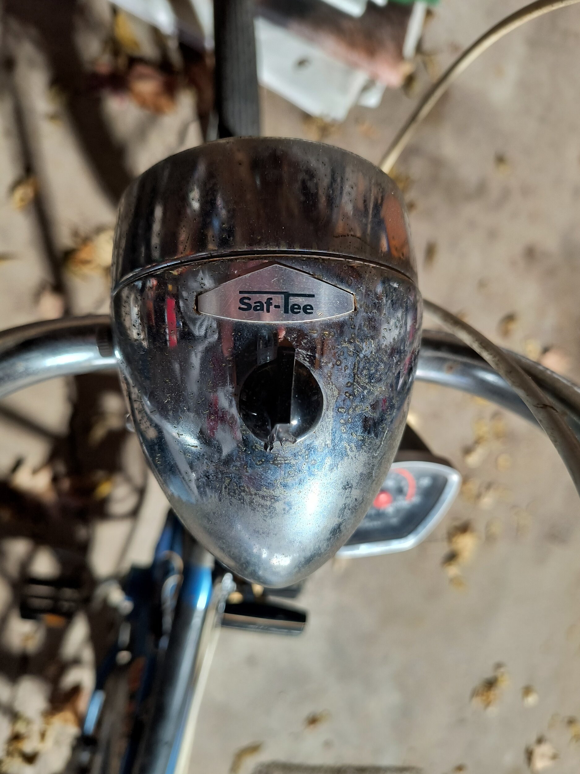

I have this headlight on my 67 Sears Spyder. Can't seem to get it functioning at this point. Just wondering is there a headlight similar to this style/shape that is strictly battery powered and does not need a generator?
Yes, absolutely; they're generically known as ball headlights, and you'll find them all over eBay, both vintage originals and modern reproductions (the latter using LEDs instead of an incandescent bulb). Yours looks to be one that was made in either Hong Kong or Japan back in the day, and sold under a number of house brands for various stores and aftermarket distributors, with the brand name of choice lithographed onto that little aluminum plate that's fitted into two slots on top. Other common brand names included BikePals, Cycle, and a few others that I will remember shortly after I hit the Post Reply button. 😉
If you're good with fiddly bits when disassembling, and it's not just a rust bucket inside, you can probably do a good job of getting it working again, as well as shining up the outside. (I usually use Turtle Wax or Dupont White Polishing Compound, followed by Meguiar's Cleaner Wax.) The usual point of failure for these is the rotary switch on top, where the brass rivet contacts inside get so oxidized that the bulb won't light. You might get things working again by shining up the rivet contacts with a clean pencil eraser, followed by a light fingertip wipe with Vaseline petroleum jelly to keep the oxidation from returning.
If that doesn't work, you'll need to remove the locking pin from the center of the switch shaft, lift off the spring retainer cap or washer, pressure spring and brass rotary contact, get the contact areas nice and shiny again, and reassemble. It will be fiddly to press down on the spring to get the locking pin back in place (needle nose pliers are helpful), but it's doable. Clean up the bulb socket, contacts, etc. as needed and try it again.
I rebuild these all the time and they're not hard to do, but if yours has other damage beyond that obviously snapped off switch lever, I would agree that finding another would probably be a better use of your time. Good luck...

P.S. In looking at that headlight shell in the generator-set photo above, that looks as if it might be the same as that in the photo by @Old is Gold, which in turn may be a house-branded battery version of the Schwinn 05 720 single-call headlight. @Old is Gold: does your light take one battery or two?

You're welcome... 👍 One thing I just noticed in your headlight photo is that yours has a gray knurled plastic knob on the latch release (left side of photo), which is used more often on generator headlights than battery models. Is your headlight actually a generator model? If so, it would have a power terminal on either the lower left or lower right side of the outer shell, no internal battery tray, and the top switch is used as a beam selector between the two bulbs inside. On a battery model, the top rotary knob acts as an On/Off switch. What do you have there? One or two more photos of the whole thing would be helpful.
