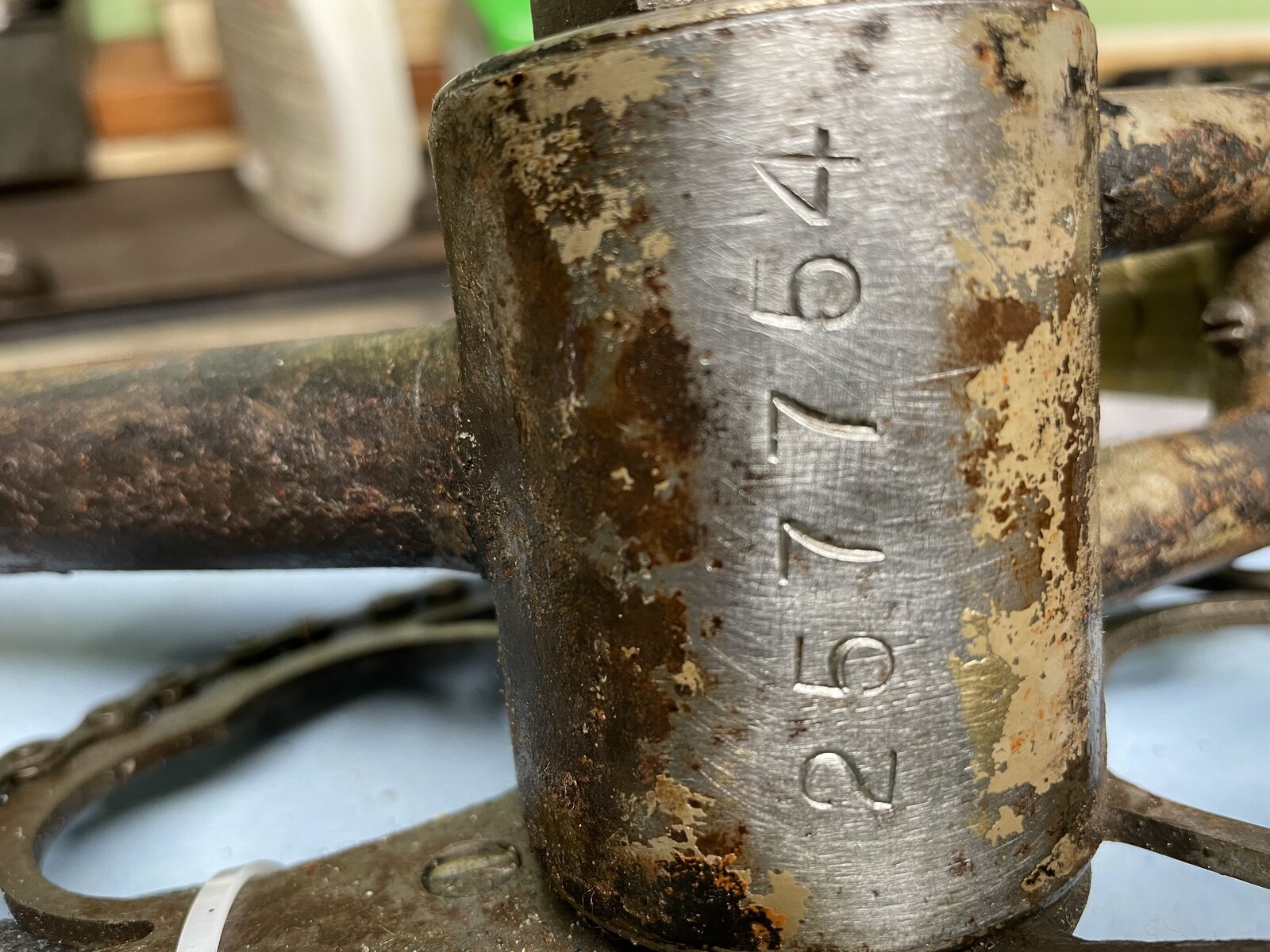

1527542
1527546
1527547

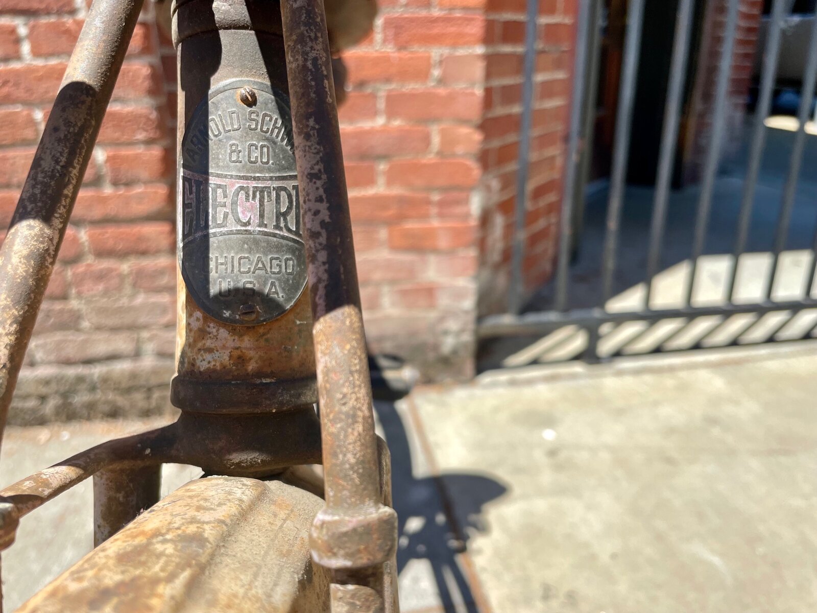

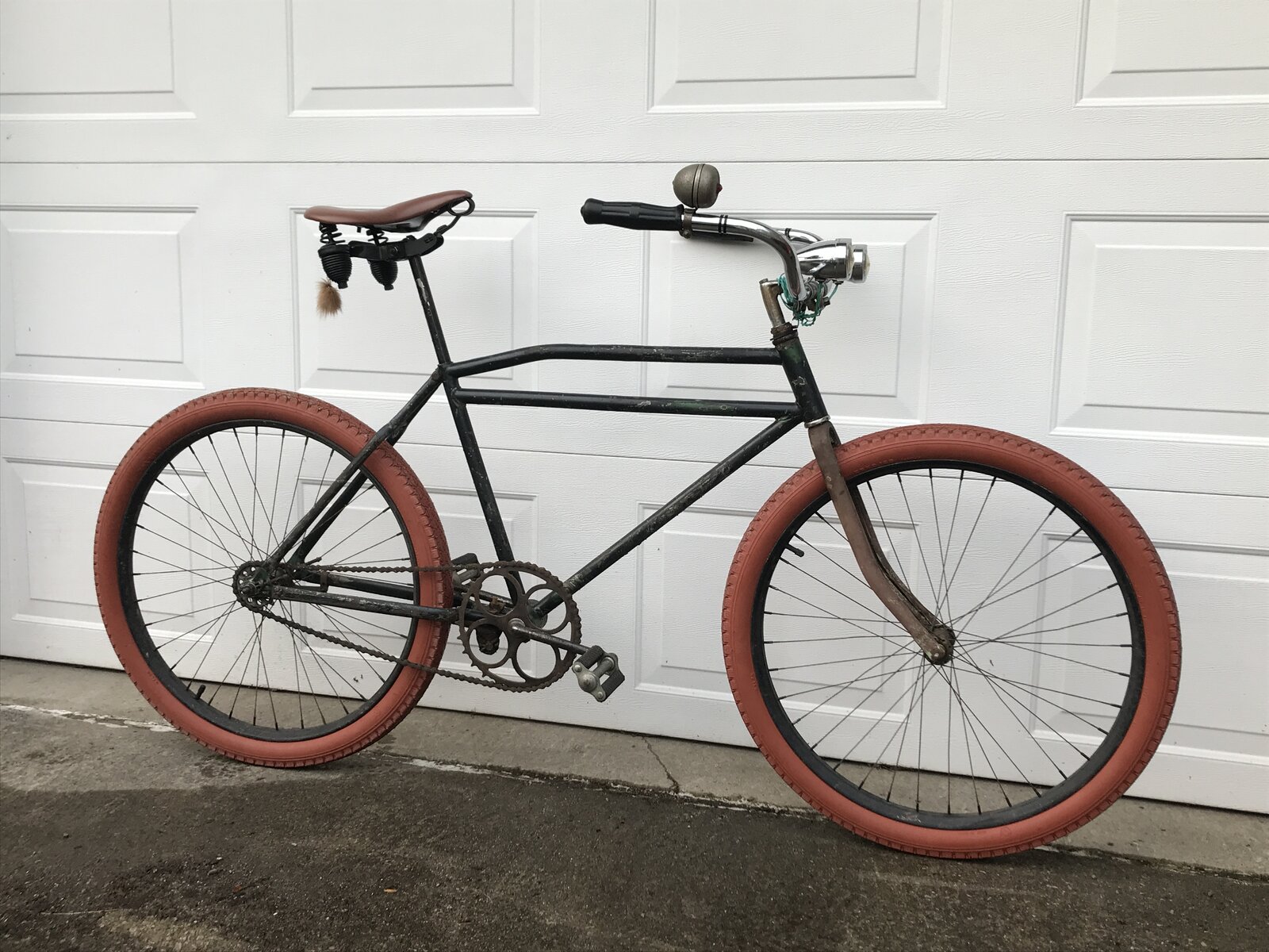

Another one of mine... Electric Badged Moto. Haven't pulled the crank yet but It's my understanding its not dated.

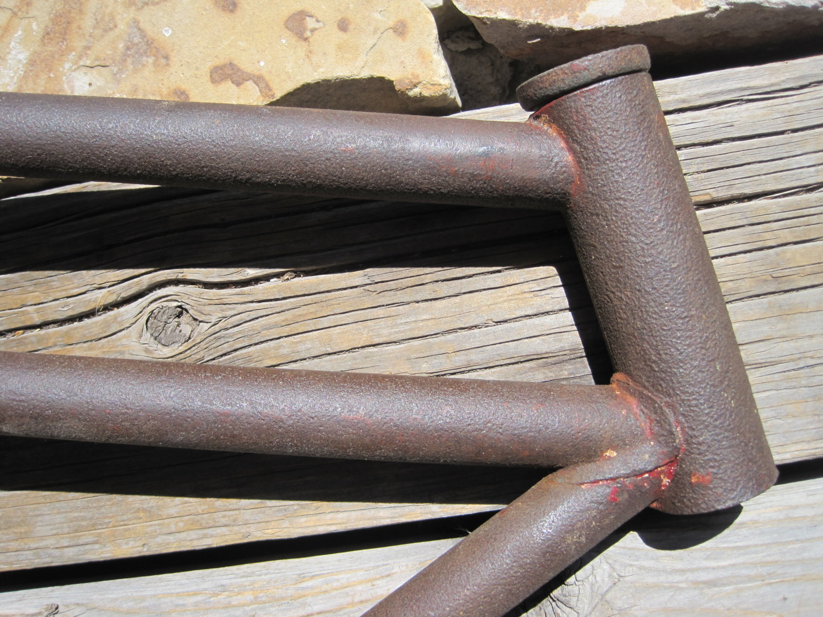

Currently leaning '22/23. In the process of breaking it down so will double check the crank. The construction on this bike is different than most examples I have seen. It has a shorter head tube with down tube starting a t head tube. The others have down tube killing into the lower (straight) bar

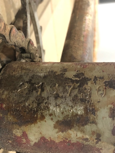

#216730

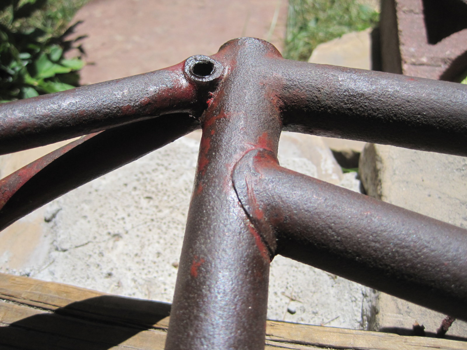

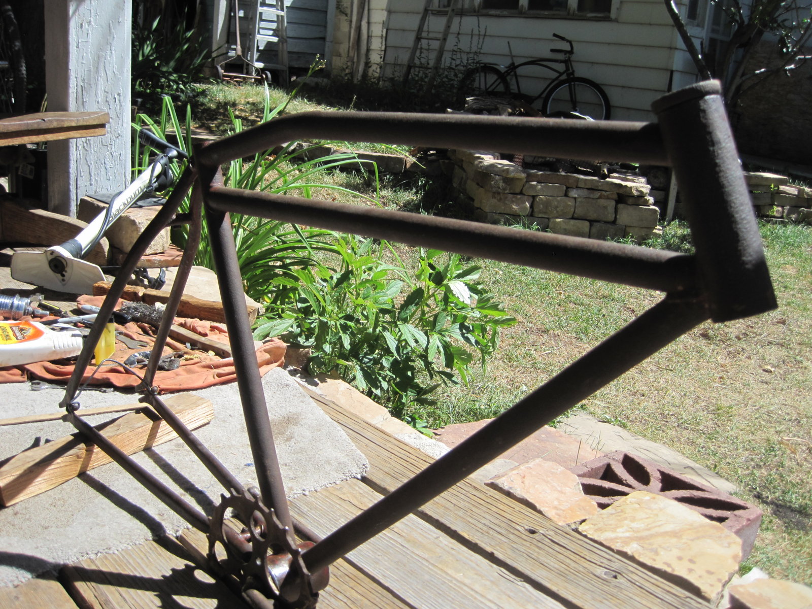

Below is an earlier 2012 thread with pictures by @chitown about his 478,500 series A&S motorbike dated to 1931.
