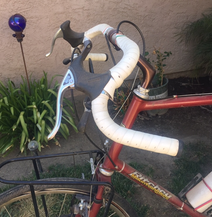

Good catch on the shifters & brake handles! Unfortunately, when I found the bike it had been converted to a cyclocross (See below) so I had to make some choices with replacement parts in the handlebar area. Bullmoose bars with the built-in stem and expander wedges are correct for '81 & '82. The catalog only specs "Suntour thumbshifters" so I used the ST Power Thumbs but I have a pair of ST XC shifters which I now think were correct for '82. I have to decide how original I want to make the bike, including correct Magura brakes & brake handles, Avocet Touring II saddle, derailleurs (which I hear didn't work well) and even replacing the cracking decals. The bike shows some scratches you'd expect of a used mountain bike and I decided I'm leaving original paint so this isn't going to be a complete restoration.
Through my research the frame features show it's definitely an Everest, no question. One quick tell-tale sign are the bump-outs top and bottom of the lightened headtube you can see in the below pic. There are other things but that's easy to see right off.

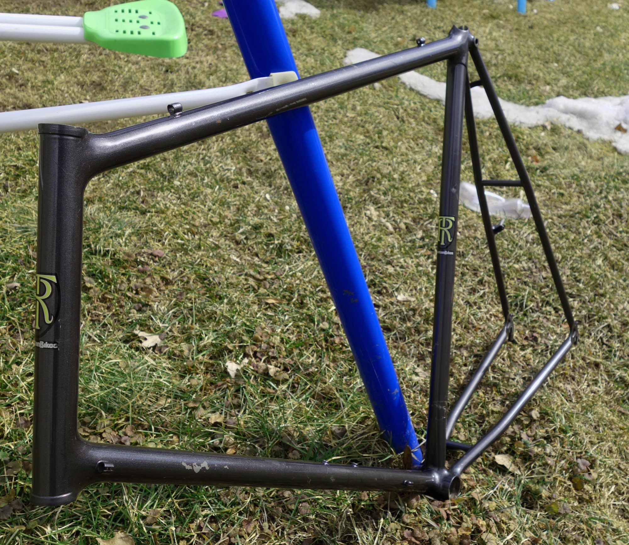

I looked at some of my bikes. I have one frame, the same as yours with the grooved seat collar and the same head tube, it has a fillet brazed bar, but its not clamp-on. I have two other frames that have the grooved seat collar but have a plain head tube.
The very large gun metal grey frame in this thread is an Everest frame.
You should look for a fillet brazed bar for your bike.
