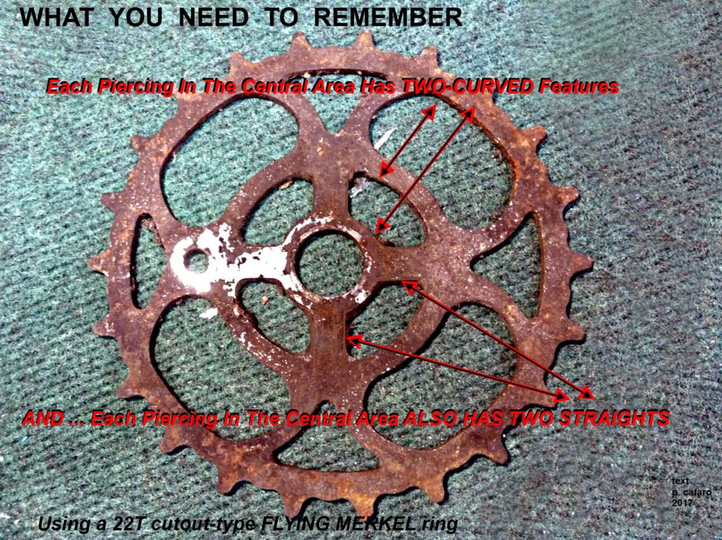

@hoofhearted @Archie Sturmer . Bump this thread. So was it determined that both Miami/Merkel and Emblem used the 2" drive pin spacing on their sprockets and cranks? Miami had quite a few different styles of both that suggest different maker/suppliers. Was it decided then that this setup (2") is correct for this particular Emblem bike?
1912-1923 Miami below.(from Flying M. site) Look closely at the differences between it and this Emblems' sprocket with the same 2" pin spacing. Thickness of spider, inner circle, etc. seem different.
@hoofhearted @Archie Sturmer . Bump this thread. So was it determined that both Miami/Merkel and Emblem used the 2" drive pin spacing on their sprockets and cranks? Miami had a few styles of sprockets and cranks that may indicate different suppliers. So it was decided that this setup is correct for this particular Emblem bike?
1912-1923 Miami. Look closely at differences between the below Miami and the Emblem of similar look and 2" pin spacing. Thickness of spider, inner circle, etc.. from the Flying Merkel site.
I have seen several Speed Well bikes with this chainring. I do believe they were most likely stock and provided by a supplier as I have seen these chainrings in a catalogue. When I get time I will take the chainring off and shot more photos.
I believe that I have that 22-tooth chain ring sprocket with a dog-leg crank somewhere; (could not find it last time that I looked for it in the garage). Seems that Miami may have had different chain ring sprockets and cranks for its own different product lines, and perhaps those sold to hardware stores. Also, seems like most of Emblems chain ring sprockets look like another bicycle manufacturer’s (e.g., Excelsior).
