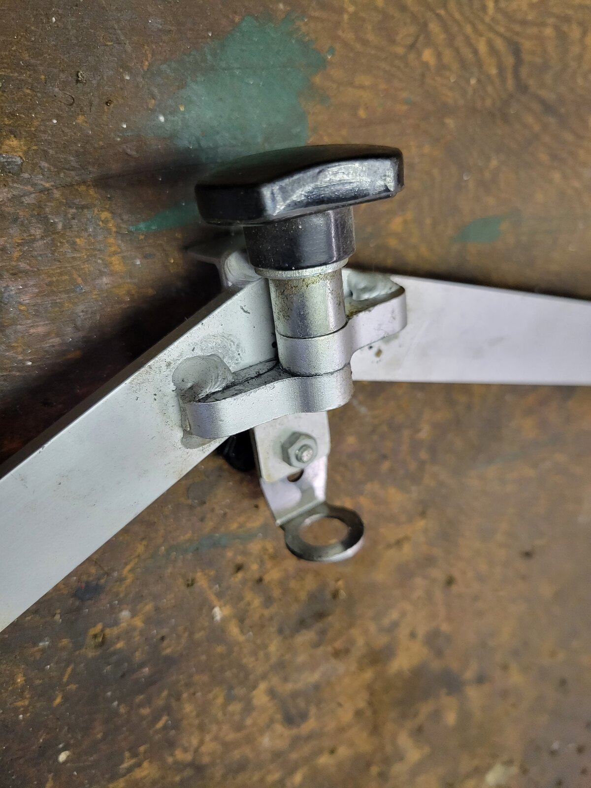

PARK TRUING STAND The Park truing stand has been the bike shop standard for over fifty years, it's a great tool. It falls into Group #1 "self-centering" stands. The fact that it's self-centering only makes it simpler, and maybe faster, NOT necessarily better. The number #1 problem with this design is the people who use the stand. In a shop setting you have many different users, and they have many different "experience levels". The stand is routinely OVER TIGHTENED when putting a wheel into the stand. This causes the stand to go out of alignment in a large shop operation. If we are talking about one stand, and a one-man operation, and you take care of your equipment it might never be a problem. But it's something that needs to be checked, and its simple five-minute process to re-adjust the centering feature. Detroit Bike, has been great in shooting me photos to help you visualize in the series on wheel building. But he sent me the Park "fork alignment gauge" photo in a PM, and I'm not adapt in attaching it to this story for the reference. EDIT, SEE POST #56 ADDED Basically, it's simple, you put the Park fork alignment gauge into the Park truing stand, and snug it up just like you would do if putting a wheel into the stand. Then you adjust the truing stand pointers until they touch the alignment tool. Likely they will show the truing stand is still in alignment. If NOT, just loosen the two Allen screws on the cross threaded handle rod. Take a block of wood and a hammer and tap the truing stand arm (while the Allen screws are still loose) in the direction to correct the misalignment. It's just something you need to confirm and adjust if necessary. The key to using this type of stand is to use the same amount of knob tension every time you insert the wheel into the stand, because the centering feature is sensitive to over tightening.

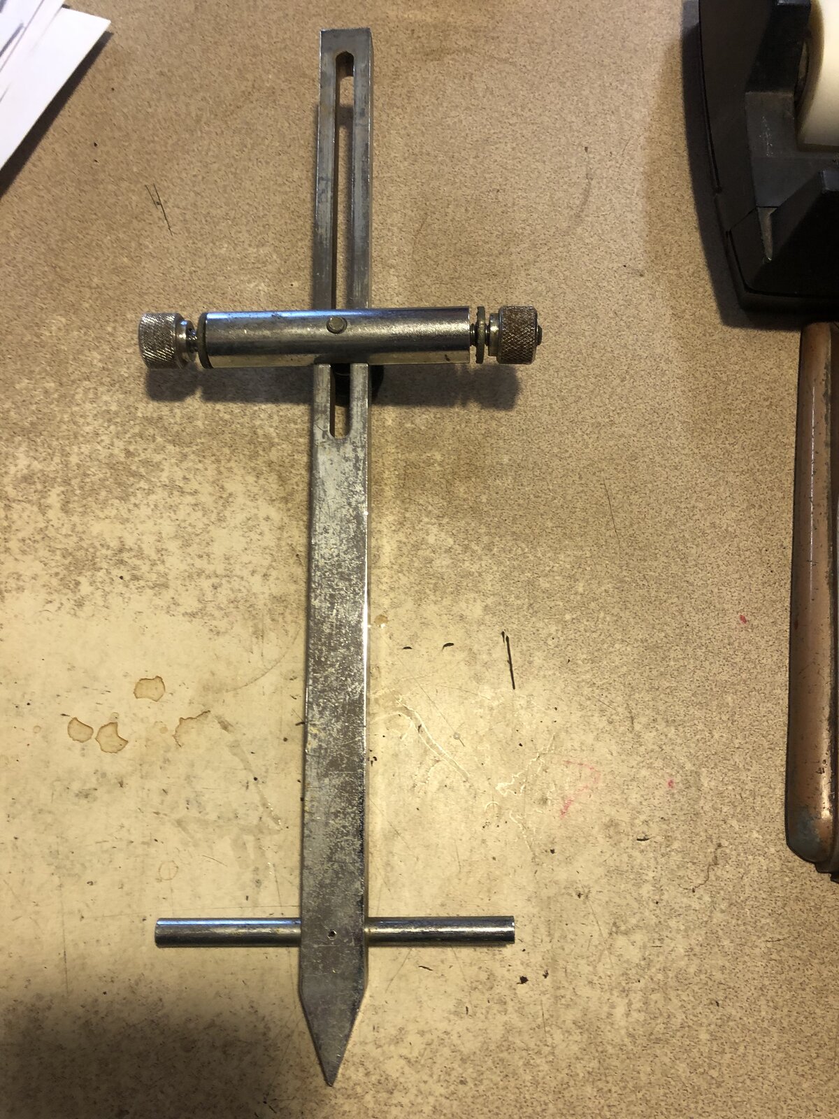

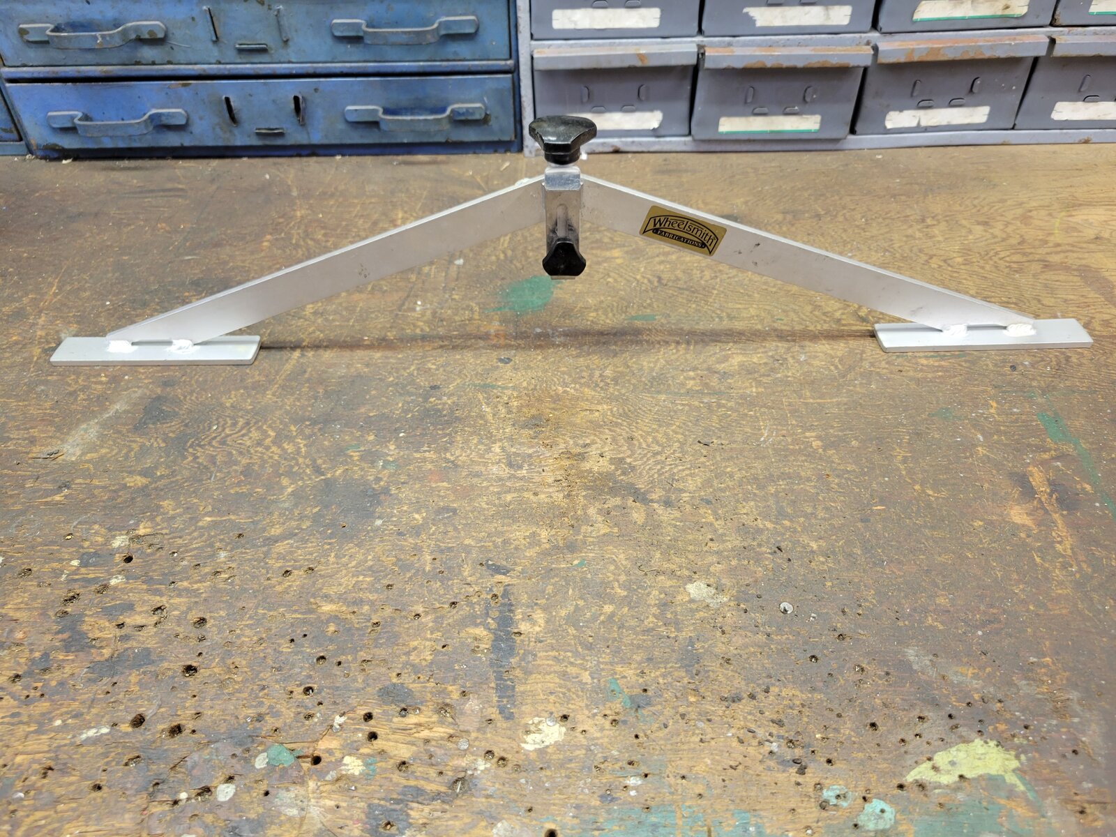

WHEEL CENTERING GAUGE This is "must have tool" for anybody doing wheel building. Marty does not like his new expensive Park centering tool, so maybe hit him up for a good liquidation price, LOL. We could all argue that you can figure out if a wheel "is centered" by simply reversing it and measuring the rim to fork distance in both positions and comparing your numbers. It's LOTS EASIER to use a wheel centering gauge. Refer to Posts #45 and #47 showing the 1969-72 Schwinn Service Manual Volume 2, page 634, figure #32 for a great photo of a centering gauge, and how it positioned to use it. It does not measure, it's only a comparative gauge. You adjust the pointer to the right cone lock nut edge and flip the wheel around and compare it the opposite side. If it's off, you need to divide the distance in one half and that is the amount you need to re-center the rim within the hub distance center.
MAKING YOUR OWN CENTERING GAUGE, You can make your own gauge. Depending on your background, and the surplus material you have laying around I could see several different methods. If your a metal working guy and have access to a sheet metal brake use some aluminum or galvanized sheet metal. Bend a 1/2" lip on it for the surface that will touch the rim. When you make this gauge, make it so it will fit 20" up to 27" diameter wheels. It needs to have a cutout section to fit over the hub/spokes. It needs to have an adjustable pointer. The Schwinn gauge in the above Service Manual had a Huret shifter handle cone spring to allow the pointed to be moved, and also stay where you set it. If your a cabinetmaker, I could see a very nice wood one made for poplar, oak, or birch. It's not difficult to fabricate something like this tool.

Heres a pic of the truing stand alignment gauge
