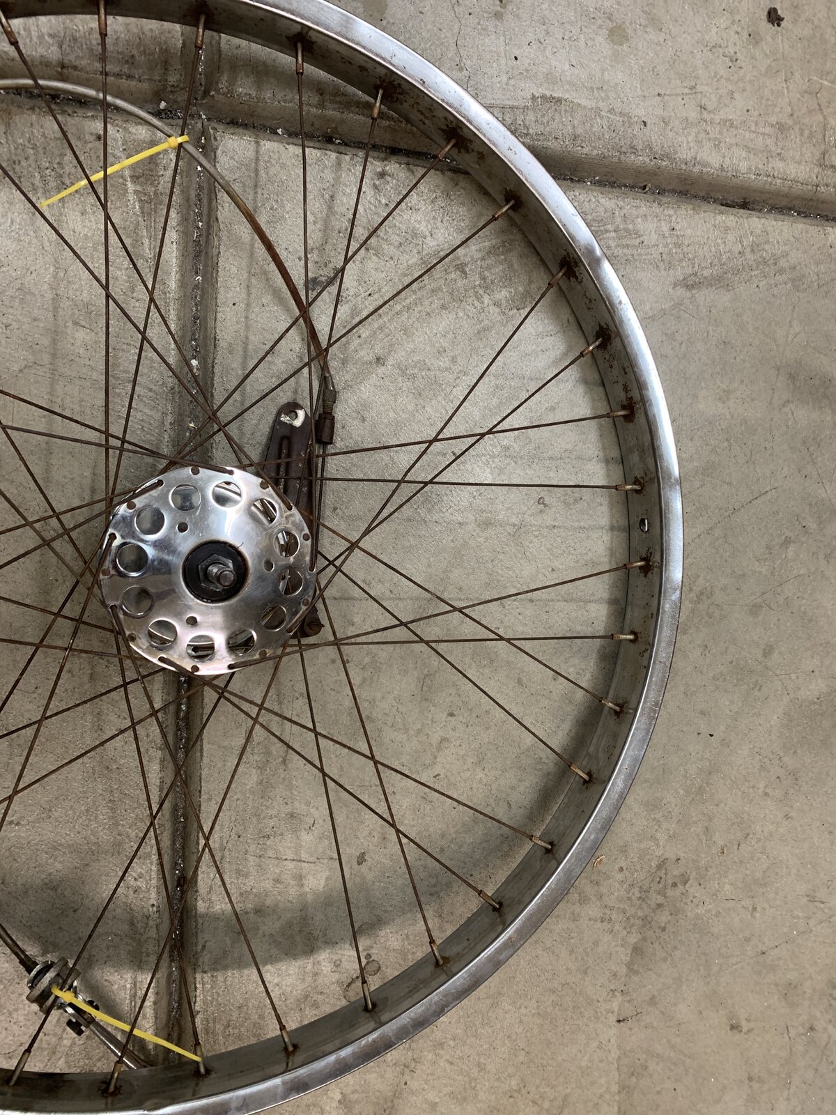

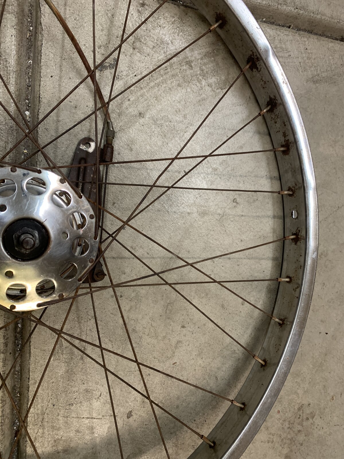

Go to the Reference wheel photo on post #29, use the second photo. Find the valve hole at 3:00
Find the yellow zip tie at 6:00.
Look at the yellow zip tie pointing at the 5:00 spoke and the spoke next to it at 6:00 (not the zip tied spoke with the brake lever)
I'm going to define those two spokes as the "Cross Over" spokes. Note one goes to each hub flange side, AND they also cross over each other. If you look closely, they repeat by skipping two spokes, then you have two more "Cross Over" spokes. You need to be able to find these two spokes and see that they repeat all the way around the rim.
Take any one of your various "pull-up" #1 or #2 tools, the screwdriver style from Park/DT/or Bicycle Reasearch, or you can try out your drill motor driven spoke pull up bit and tighten ONLY the Cross Over spokes you just located. Assuming you have chosen the correct length spoke size from Marty's nice spoke collection, when you use the pull up bit, or screwdriver it will kick out from the nipple at a point that it is not over. or under tightened. You are only going to tighten 18 spokes in your 36 spoke wheel. The Two Cross Over spokes, skip two spokes, and tighten the next two Cross Over spokes. Repeat the two tighten, two skip, two tighten, two skip all the way around the rim. If the spoke length was correct, you will have a wheel that is almost snug, you were able to make it all the way around the rim before it got "too tight", the wheel will be "round", and the wheel will be "straight", and the rim will be "centered" with in the width of the axle spacing. Yes, frigging MAJIC. Next you have to go back and tighten the remaining 18 of the 36 spokes. The wheel will remain round, straight, and centered. If you tighten the spokes as Marty explained by equally tightening all the spokes in sequence around the rim, you will be able to tension it, but it will not be round, straight, and centered. The wheel is not done yet, but it well on the way for final truing by hand in a truing stand.
