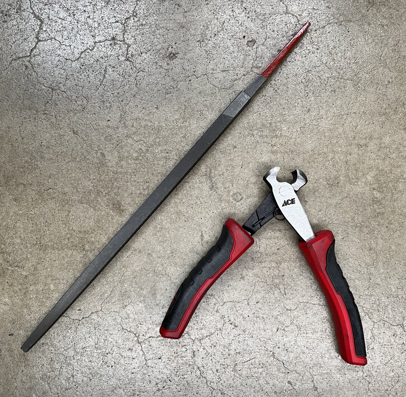

I just use a regular set of hardware store nippers and a square file, for any spokes that need to be trimmed.
But, trimming of the spokes should be minor, if at all, if the right size spokes are used to begin with.

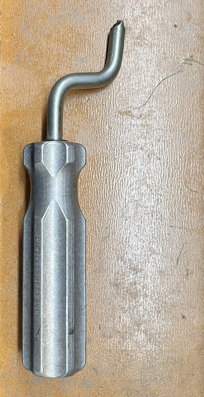

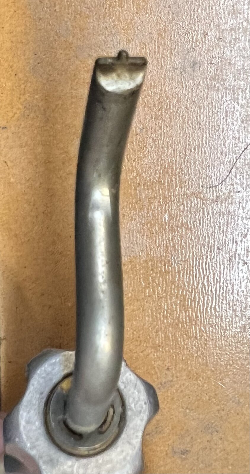

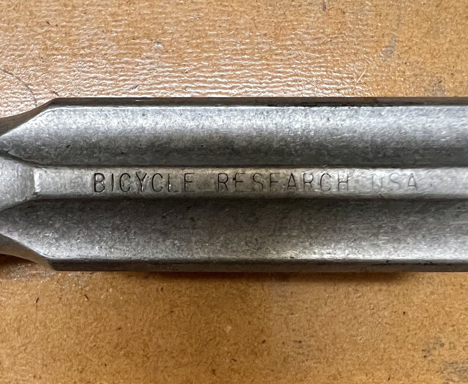

Here’s that nipple driver from, Bicycle Research, USA.
The key to this tool, is that it’s designed to run up the nipple to just before the point of tension, so that the spoke/nipple engagement is equal among all the spokes.
(Assuming that the correct length spokes are being used)
Notice the little tip on the screw driver blade.
When that makes contact with the spoke end, it pushes the driver out of the slot, to stop any further tightening of the nipple.

The little tip on the end of the blade of the Research nipple driver is there to limit the amount of run up on the spoke.
The idea, is to start with an equal amount of spoke engagement, before the tension/truing, and dishing process begins.
Then it’s a give and take process between all the spokes while centering radially and laterally.
You should end up with a fairly equal amount of engagement, once the wheel has been tensioned and trued.
A rear wheel has a fair amount of dish, so the right side will show more nipple engagement than the left side.
But if you start with all the spokes with the same amount of engagement, and take from one side while giving from the other side, you’ll end up with a minimal difference between the two sides.
