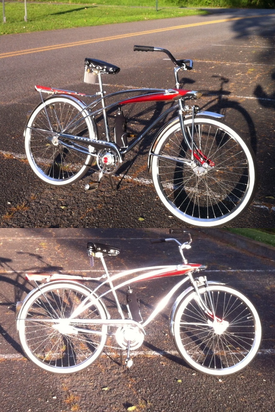

1964 SPACELINER Deluxe today two pictures taken at the same time only stepping aside for different angles.
SPACELINER PHASERS SET TO STUNNING!
BeEp! bEeP!

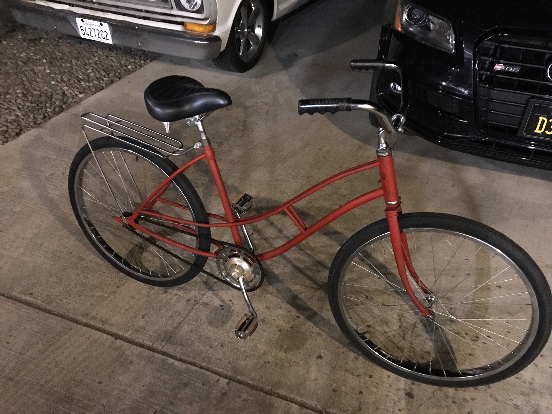

Just grabbed this from a local CL ad. Not a whole lot to go off of here besides the frame itself. No badge or chain guard. I'd like to know the year and which model it is. Any help?
MOU 315167
Justin
It's not a Spaceliner. It's something from Murray, but beyond pointing you in that general direction I'm not enough of a Murray expert to tell you what it is. Perhaps if you post it in the general Middleweight Bikes forum, and ask "What Murray is this?" you'll get a quick answer from the Murray experts.
Somebody altered the men's bike by swapping out the original rear wheel for one with a manual two-speed hub. The springer fork was also a swap, not an option (it was taken from a chromed, deluxe, model). The original fork would have been painted red.
Based on the serial number of the womens' bike, it looks as though somebody swapped on the two-speed kickback hub from the 46931. That's a nice upgrade to have, even though it isn't original.
I think I have a Sears catalog that gives the option of a 2-speed kickback. They might be factory or "dealer installed"
The "option" was to buy the model that came with the 2-speed kickback hub... it wasn't available as a dealer installed option. You simply ordered the 2-speed model. In this case, the poster has a model that was originally equipped with a single speed hub from the factory, but has at some point been retrofitted by an owner with a 2-speed hub, which essentially turns it into a model 46931.
