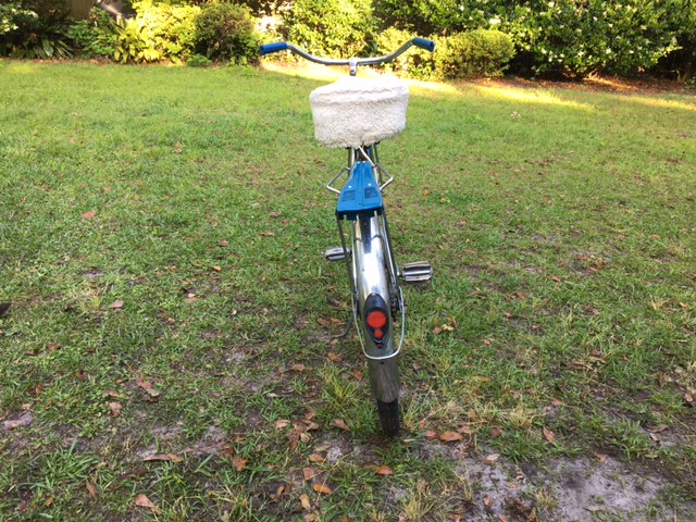

Just got my Spaceliner and it needs help. The confusing thing is that the model number lists it as a Standard, but it has a tail light. Here's the first part of the numbers 502 469800
Most likely somebody swapped off the original rack for a deluxe rack and tail light at some point in the past. Your front fork should also have truss bars (no springer), as it was the springer fork (deluxe) version that came with the tail light.
Here's what the rear view of the model 46980 should look like.

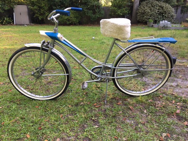

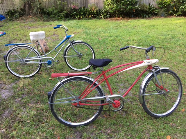

Hello all. First time poster here. I just picked up a pair of Spaceliners last night that I noticed were overlooked in our local market. They were listed individually with a generic title like "Old Bike". I did not know what they were, but they certainly caught my eye. It took a good Google image search to figure out what they were. From there I found this resource and learned about them. Made arrangements and bought them.
Anyway, I'm new to the classic/vintage bike fixation and have been more focused upon steel road bikes. So these are a little out of my wheelhouse. I think they are awesome though.
I was not sure if this was the correct place to post, but I thought this scenario/question and the answers might be insightful for future visitors with similar situations.
Thanks to this wonderful resource, I found the men's bike is a 46303 model - basic painted model spec'd with single speed and no springer fork. However, this bike actually has a chromed springer fork and a Bendix 2 speed manual hub/lever. Could this have been the original set up? Meaning, were there options for custom orders for these bikes? Otherwise, I guess it must have been upgraded at some point in it's history.
Here are some pictures I snapped quickly this morning.
Any other non-standard features on that one? (Other than the missing parts)

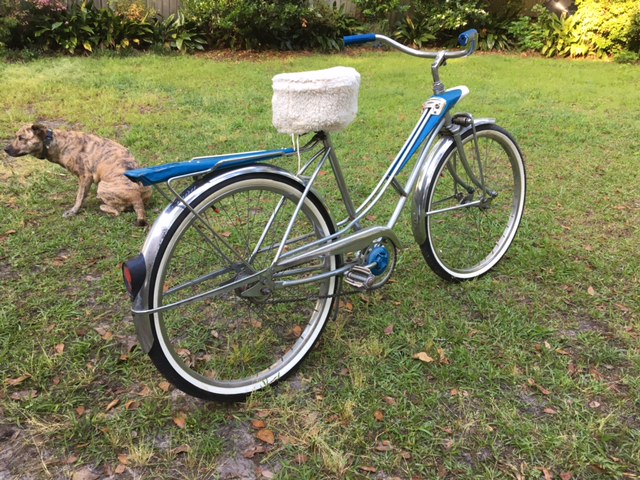

Also, thought I'd just share the women's bike. I am pretty certain the model number on stamp was 46911, which is the 64/65 single speed deluxe. But the hub has the three recessed red rings, which is indicative of the 2 speed hub, right? I will double check that serial number stamp tonight.
I just bought these last night. I am still undecided if I will keep them to restore myself, sell the set, or part them out to maximize the flip.
Anyway, thanks in advance for any info.
Somebody altered the men's bike by swapping out the original rear wheel for one with a manual two-speed hub. The springer fork was also a swap, not an option (it was taken from a chromed, deluxe, model). The original fork would have been painted red.
Based on the serial number of the womens' bike, it looks as though somebody swapped on the two-speed kickback hub from the 46931. That's a nice upgrade to have, even though it isn't original.
