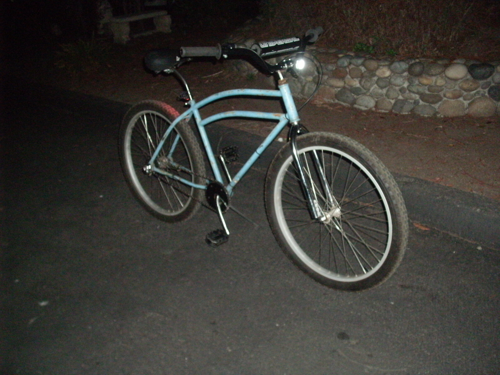

Last week I forged brazed on head tube extensions. Today I started to clean off the flux. In the spring I’ll spot sand blast them to get off the flux in the groves.
Cleaned off the flux today so I could see if the molten brass made it into the join.
Looks bad but worked. Good enough is perfect for a hack bike.

Forge brazing in a fire pit. Made a mess but worked.
Lead over rough brazing. They brazing flux hardened like glass and is very hard to remove. Lead won’t stick to areas where the brazing flux remains. It’s not water or acid soluble. You have to grind it off. I can’t get in the tight spots to remove the flux.
I did the rough sanding and ink blue satin paint today.
