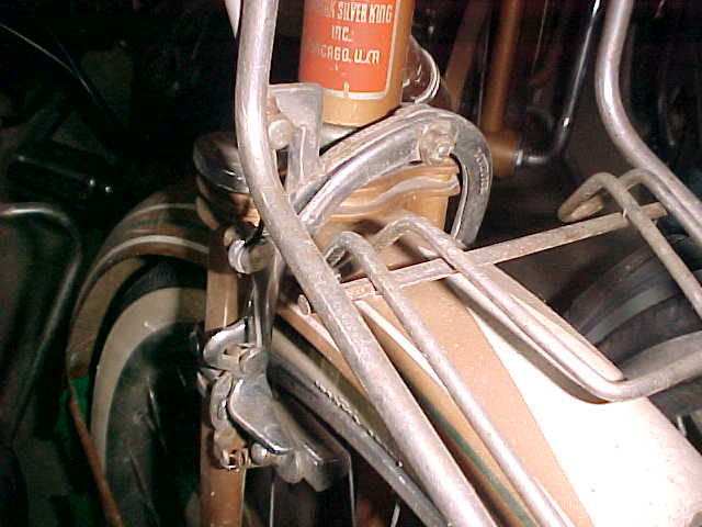

So I saw this Monark-built Firestone on FB, my first impression was the Firestone version of a Monark Bearcat. I messaged the seller several times but never got a reply.
The Bearcat was Monark's take on a three-speed with caliper brakes, but looking at these pictures, these brakes look like they mount differently than the Weinmann calipers on other mid-'50's three-speeds. Instead of being mounted on a stud they look like they're clamped around the frame tubes. I asked the seller for some close-ups, but no response to that or anything else. Does anyone know what brakes these are and has anybody got some good close-ups?
I can't tell whether this was a production option or an aftermarket set-up. Maybe Monark decided this was cheaper than modifying the frame?

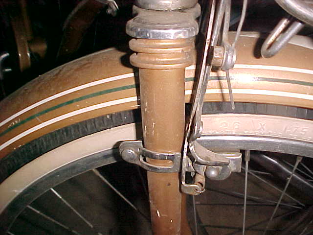

I don't think that front brake is supposed to be there, it's not hooked to anything on the fork, and the clamp on the handlebar is kinda funky. Maybe it's just sitting there for the pics. At a close zoom view they are clamped to the fork, my bad.

I have a 1957 Monark middleweight with a similar front brake setup which is attached to the fork legs. The rear is a Bendix manual 2 speed coaster brake.
Oilit
Can we get some pictures? I'd like to see exactly how those calipers are mounted, this is a new one to me.

I think this is the best view of what's going on. Note the clamps on the fork. It looks like they are similar to the Schwinn add on cantilever brakes.

They're all very similar to TOC French brakes in design.
The reason this style of attachment disappeared from use is that they are very flexible in operation.
I have a couple of old French made ones on TOC bikes but they aren't that effective!
Interestingly you can still get a couple of modern variations on this theme, aimed at people (myself included) who like to use fixed gear, track racing bicycles on the road when you have undrilled forks and are unable to mount a caliper brake.
Over here in the UK it is illegal to ride a 'fixie' without a front brake!
