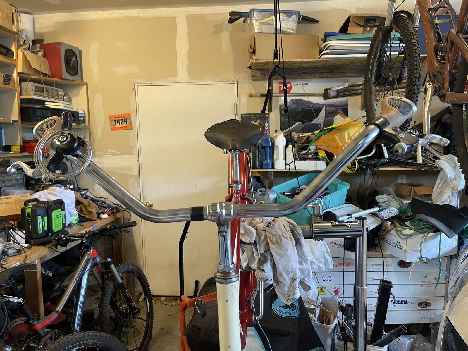

Dry fitted the thumb shifter, the brake levers, and put on some KKT pedals. Not exactly period Correct, but close enough for the vibe. No purity tests. The left brake lever is bent down a little bit so I have to mount it twisted up higher than I like but I’ll either just deal with it or look for a better brake lever along the way in the parts bin at BBP.
