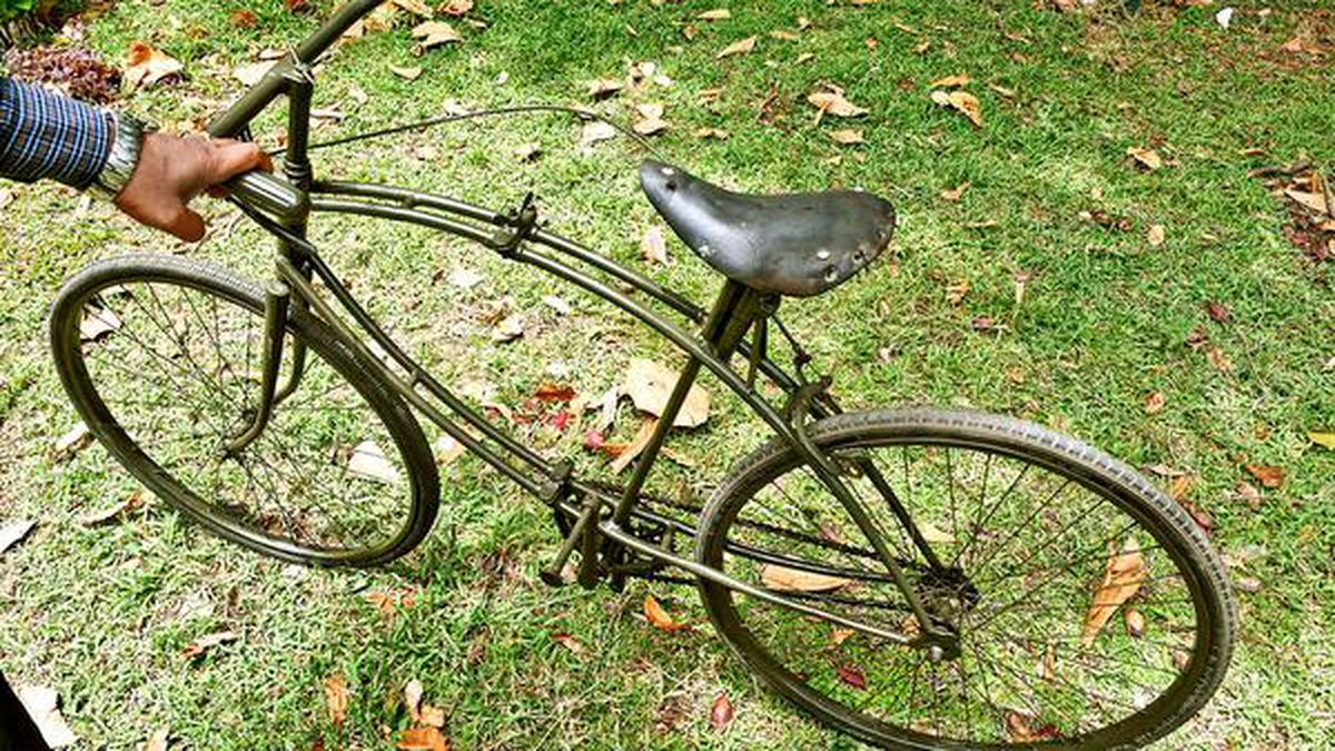

Unknown. R.Ravindran India.
Unknown, Vikram Pendse Cycle Museum, Pune, India.
Photo: Vikram Pendse
