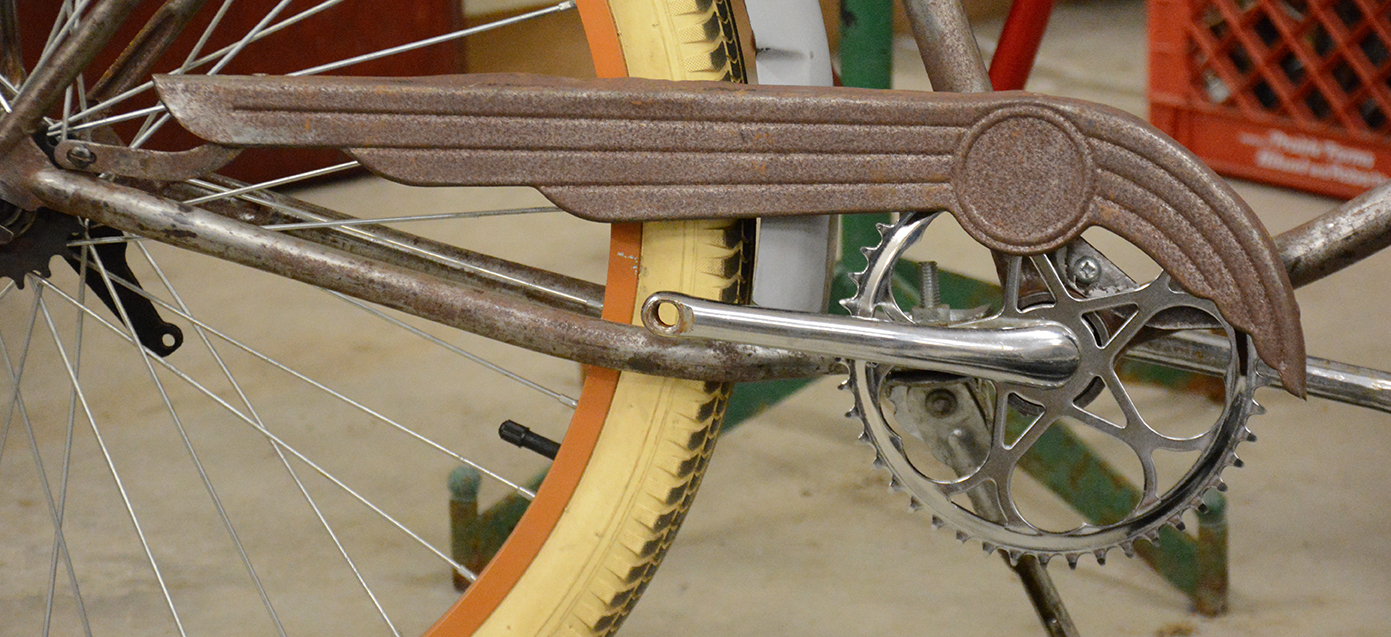

Back in 2019, one of my relatives helped me modify a few parts and fix a few problems with the frame. Unbeknownst to me, he also modified the original chain guard, even though I didn't ask him to. I was bummed at first, but just last night, I figured out that the changes he made to the chain guard made it fit closer to the smaller chainring, since it originally fit around a larger skiptooth chainring. It sits a little lower and further back than an original, which is pretty neat. The dent in the rear fender shows a little more as a result, but whatever.

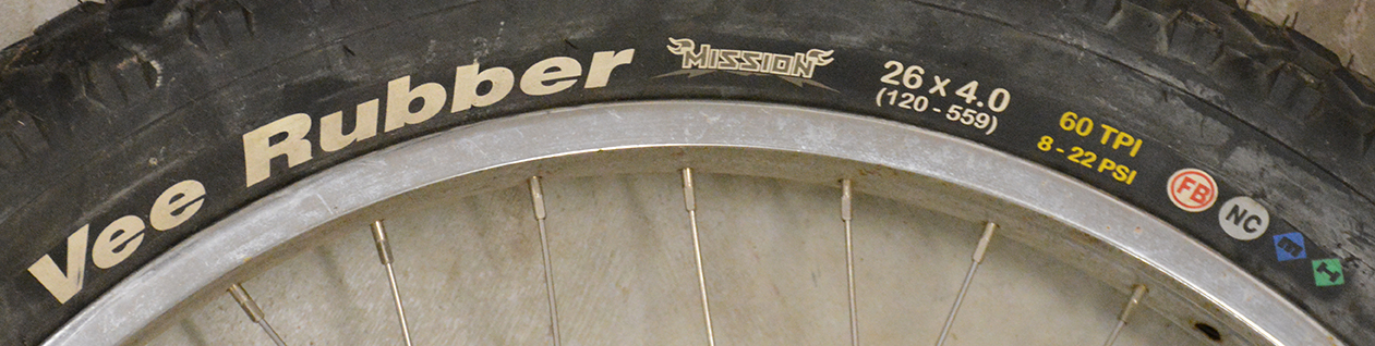

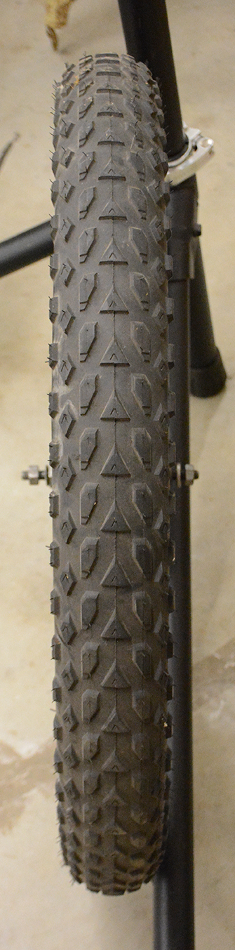

I also had some fun on Tuesday shooting some car photos at a fellow Rat Rod Biker's place, where I bought these 4 wheels and tires for this bike. I admittedly have a ton of 26 inch wheels already, but I have very few matching pairs. These will help take care of that. One set is your run-of-the-mill Walmart aluminum wheels, but the other wheels are these old chrome wheels, with 26" x4" fat tires and a GIANT (too me at least) Bendix coaster brake hub.
These tires are cool and all, they're in great shape despite the dust, but I have no use for them. I don't need mountain bike tires, especially ones as hefty as these, so I'm just going to put these up for sale or trade here later. No idea what these are really worth at the moment, so any advice would be much appreciated.

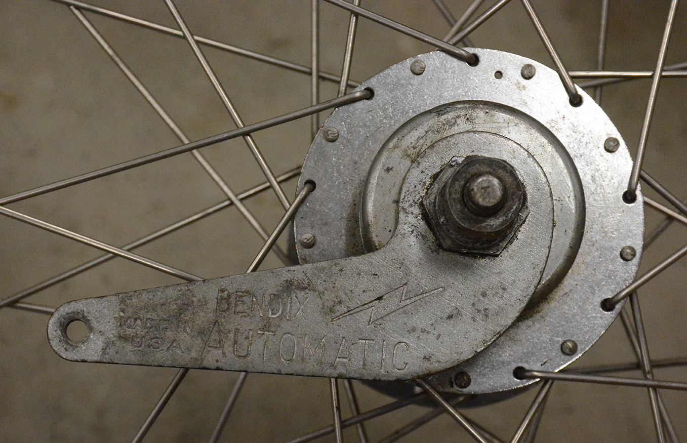

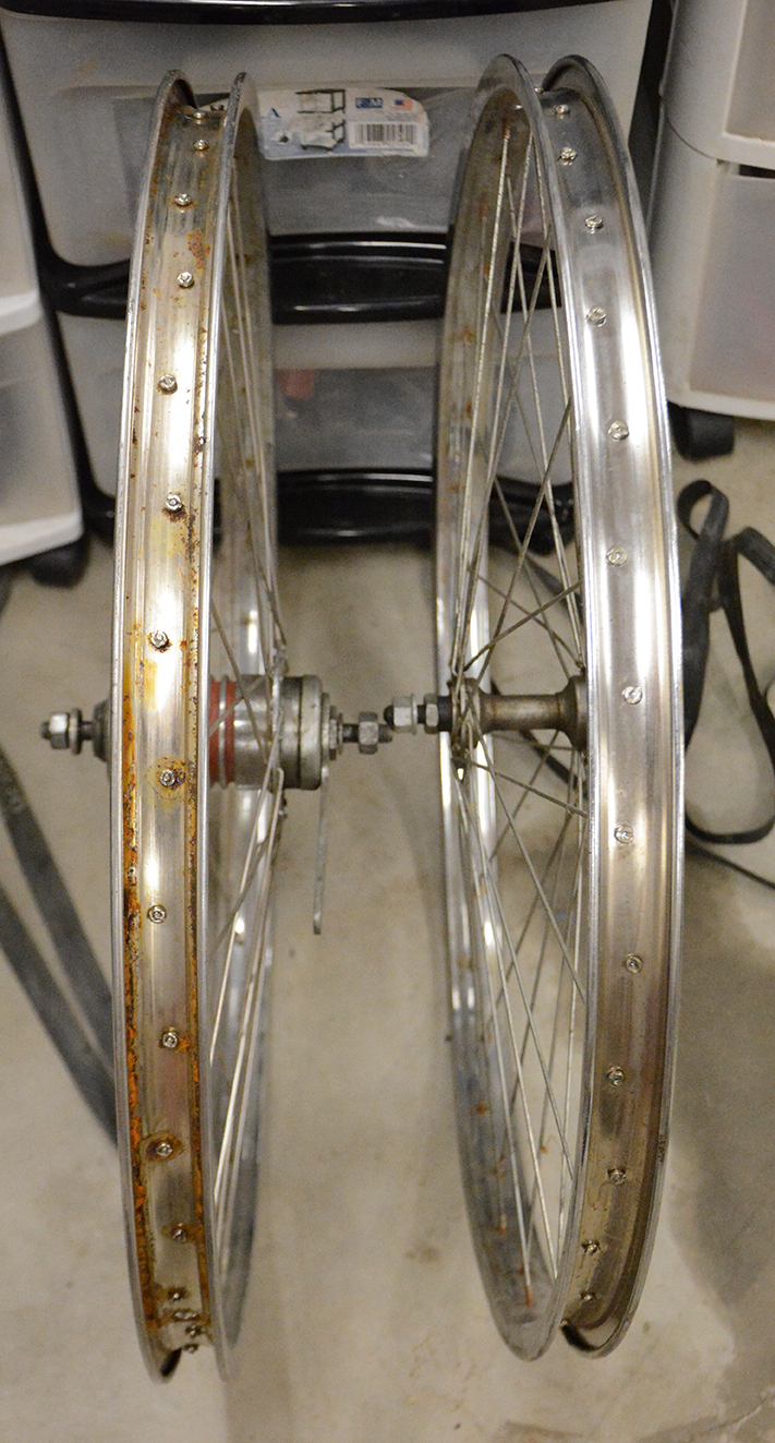

Here's what I'm really interested in: this massive Bendix Automatic coaster brake hub. It needs to be taken apart and serviced, as it doesn't move like it should, but it looks complete at least. I have no idea what kind of hub this is, though. Is it a multispeed hub, or is it just a big honking coaster brake? There's no axle hole for a shifter, so how does this bad boy work?
One last big surprise: When I took the tires and rim tape off, I was pleasantly surprised to see that the spoke nipples are all nice and shiny up top, even though they have a little surface rust on the sides. The insides of the wheels look good too. The surface rust you see on the rear wheel is really just the worst of it, and it should clean up easy enough. The front wheel, however, looks almost like new on the inside. I've never seen and old wheel this nice and shiny inside before!

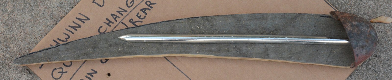

Here are some ideas I came up with for the tank: You know how those '50s Monark bikes had this chrome wraparound piece at the front of the tank?
Well, I've been thinking about emulating that element with a pair of steel toes. I tried figuring out how to use them along with some VW trim to see if I could come up with something I like. Just pretend the trim strips are curved to follow the tank, as that's what I'd do with them. I'm not sure about the design yet, but I think it could look cool if done right.

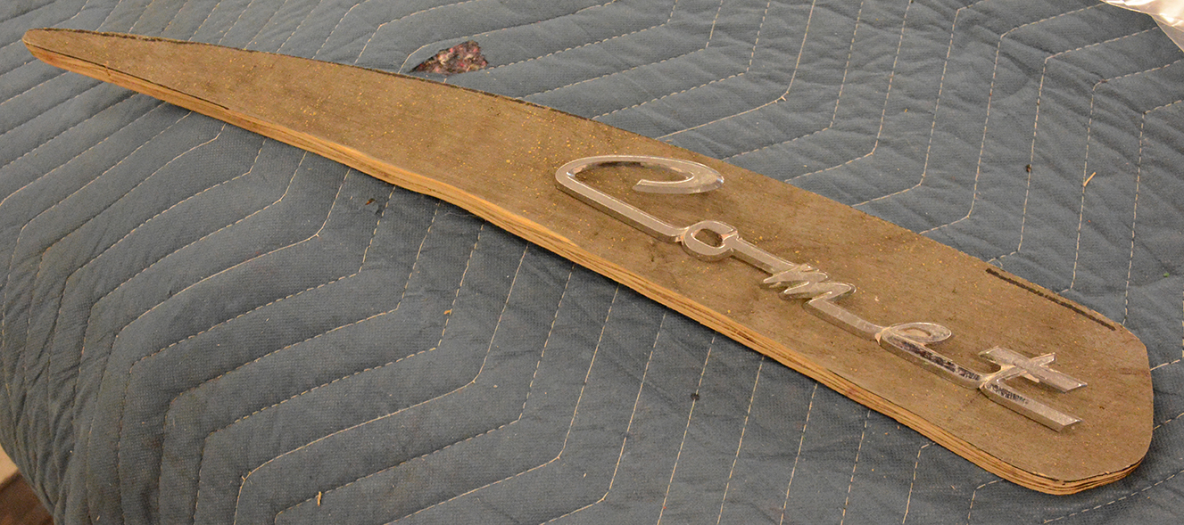

I also have a couple of these Comet scripts that might work for the tank as well. They'd certainly be the easiest to attach, give that they're flat on the back.

Cool! So it's a 2-speed? How does it stop then?
2 Speed kick back, It's a coaster brake. To change gears you kick back to brake but don't push hard enough to stop, just kick it back quickly, lightly and go.
Okay, thanks.

Superman1984
@Bike from the Dead I don't remember if you ever told me or your 1st name but let me see if I can help you out some; "tanks" side panels can made from decking boards from Lowes or Home Depot
1395286
This is 1 1/8" treated 1 side of a project I started working on. Cut out with a jig saw & sanded. I spray bombed it & then scuffed it back down to get some grain to show through. You can scribe/scratch where the tank needs to bevel or contour to the frame snug. Chisel & sand it into shape. You can drill it for screw through or wood dowels if you don't want screws showing.

Superman1984
For the moulding trim consider this; if it is aluminum then you will have to anneal it before any kind of shaping & too hot will melt it. If it is Chrome pot metal it'd still have to be heated but a round metal dowel rod can help shape it & contour as you heat it. Now a easier suggestion would be the cheap peel & stick chrome trim for autos; different widths & contouring. Up close is the only way you'd see the difference
