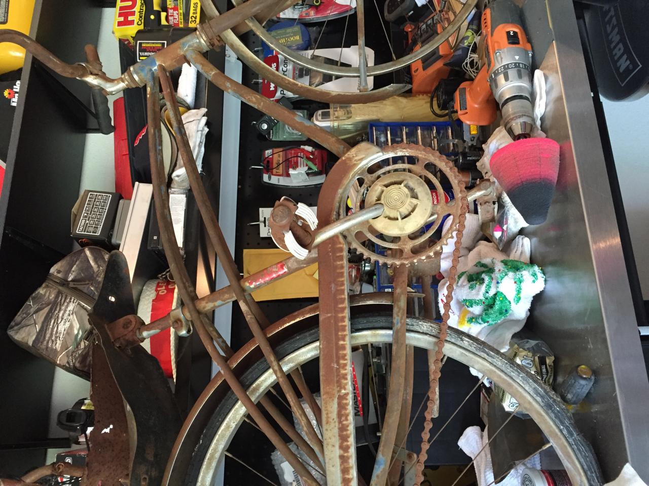

Found this Sears spaceliner but the vin number is weird it reads 6...66 and that all other then mo. To the left about two inches away?

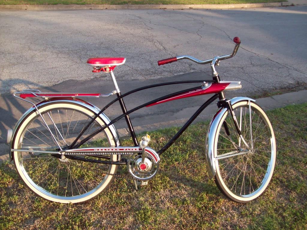

It's definitely not a Spaceliner. It might be a Western Flyer Cosmic Flyer judging by the scalloped chain guard, built by Murray.
The chain guard looks a lot like the one on my Astro Flite-

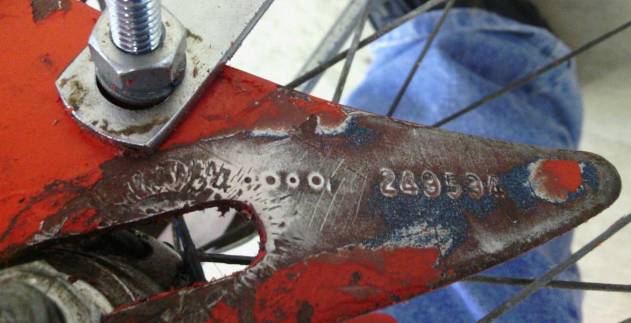

Does anyone have an idea about this serial number? Theres a 2 stamped on top of the 0 for the fourth digit.
That's interesting. The frame must have originally been earmarked for a single-speed hub, but was changed to a two-speed Bendix hub, thus the change of the digit from 0 to 2. Both are deluxe models, with the only difference being the rear hub.

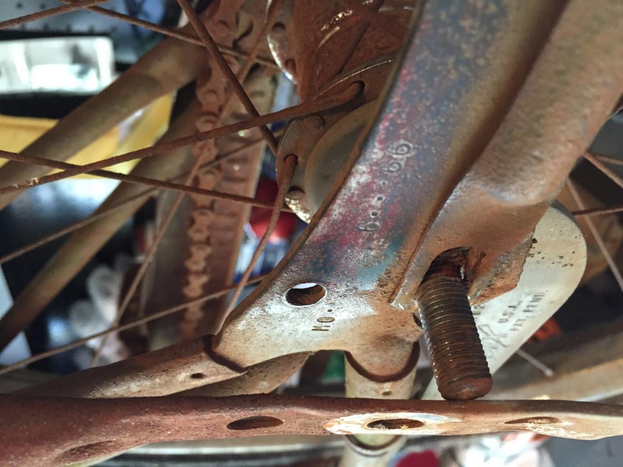

Here are pics of my Spaceliner numbers. It is extremely hard to make out in person as well as on photos. It has a clip for the tank and had the forks of of a springer all though the rattrap had been removed.

Doug, looks like a western auto stamping. Erhaps there is a "MO" stamping preceeding the "4".....Let's see the whole bike.
Many think they have a Sears sold Spaceliner when they in fact may have one of the Murray clones of the Spaceliner.
The serial of the Sears Spaceliner and many other Murray thanklight models, should have a "MO" and number or letter prefix stamping.
