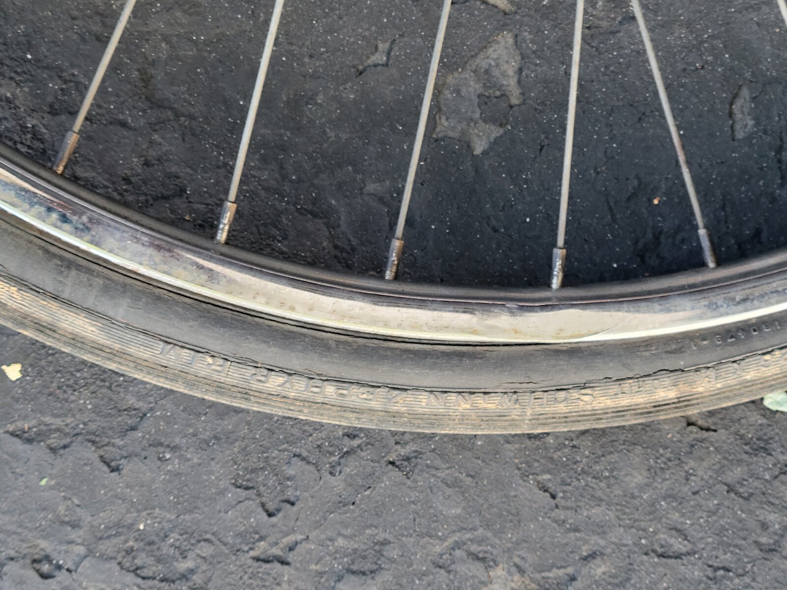

The tires have age quartering, but am not sure what the year should be to start with. I found through the catalog that the whirlwind tire was stock on the 42 w1m and the breeze tire was an available upgrade. 3 speed hubs were not available for ordering.
The rims appear to be slightly different from tubular s5 ones made later. I guess these are painted superiors, and were stock on the coaster version, but they are otherwise unmarked as to being either superior or zephyr. Same overall schwinn size tho. The spoke nibs no longer blacked but are not brass, but steel.
The original schwinn whirlwind tube valves, all metal schraders, pulled out of the tubes while pumping up. Not sure if they can be re-valved, never heard of it. I have been able to replace them with some Bates tubes i had laying around to keep the look. Including pictures of the markings on the original tires, now on storage rims to stretch them back into shape. Plus a couple overall pics of the current build, with schwinn marked stimsonite reflector, cat plate topper, and some lights added for the local 6mi "glow rides"

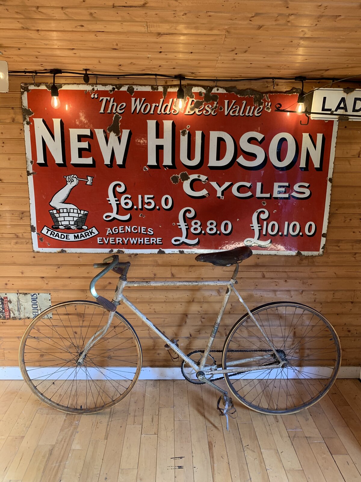

Cool and unusual New Hudson sign. I've got an early post-war New Hudson Silver Arrow with a Reynolds 531 frame in line for cleaning and reassembly.
I love looking at the stuff in the background of peoples pics too @SirMike1983
