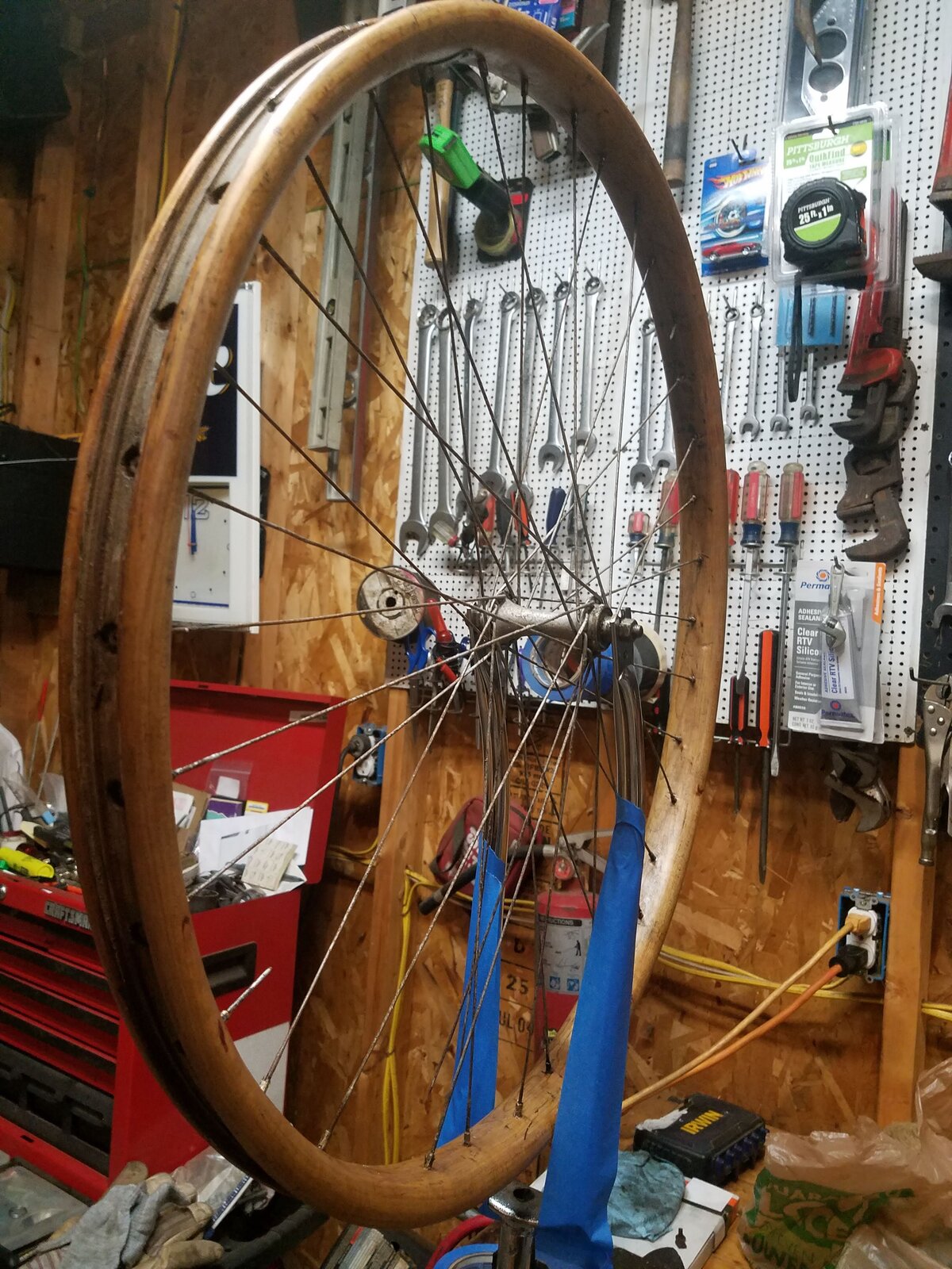

Rubinas will fit wood without steel insert also.

Rubenas will also fit wood rims with steel inserts:
These rims on my 1906 WKC are the original ones - pretty sophistacted for a ladies machine of this age, since the inlays are actually made of alunimum !
The Rubenas did not need any alteration to be mounted on these rims.
The tires are actually the only not original part on the bike, even the chain still has the WKC-maker stamps on the links.... but enough of this- I don't want to spam this post more than I already did ;)

no modification to the rim.....gentle heat and manipulation, and they locked right in....run it at lower end of psi, ......no problems yet.
