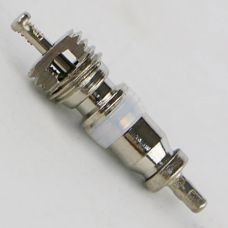

the air valve one had a spring & one did not assuming lost at some point?

the tubes seem in good shape, one valve came out with the spring the other spring was missing.
don’t imagine the the spring that goes with the schrader valve is available?
valve cores for schrader are readily available at any bicycle or automobile parts store and cost only a few cents

the spring under the scrader valve was missing not sure those are avail.
