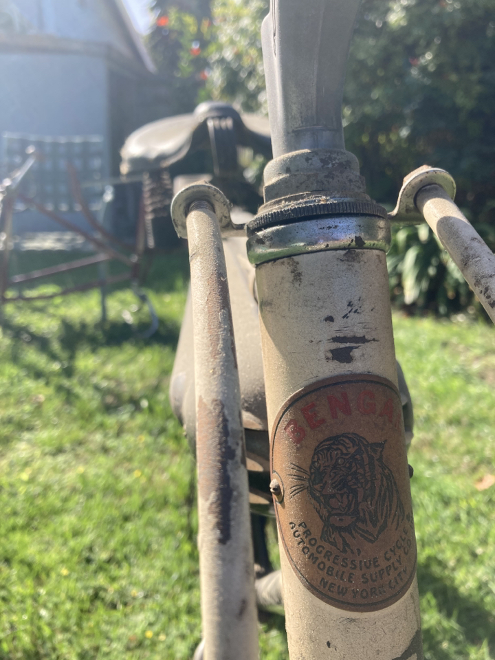

Here's the only two other Progressive Cycle Co. New York Comets I have listed:
1931 - https://thecabe.com/forum/threads/pre-war-comet-motobike.48716/
1938 - https://thecabe.com/forum/threads/n...ecial-275.128603/#lg=attachment781550&slide=0

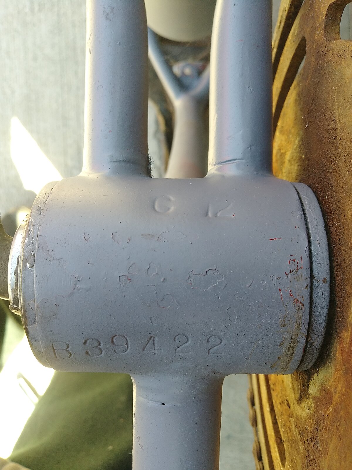

Here's a neat one to add... Late 1936 early 1937 Elgin Robin C12 over code B39422 serial!
I recently picked up this unfinished project... the frame, fork, crank and wheel set are original and I am thrilled to have it.
N
Hi Nate,
quite right, December 1936 frame, 1937 serial number. Several with earlier serial numbers in 1937 have D3 dated frames, so it looks like it was built up March-April time.

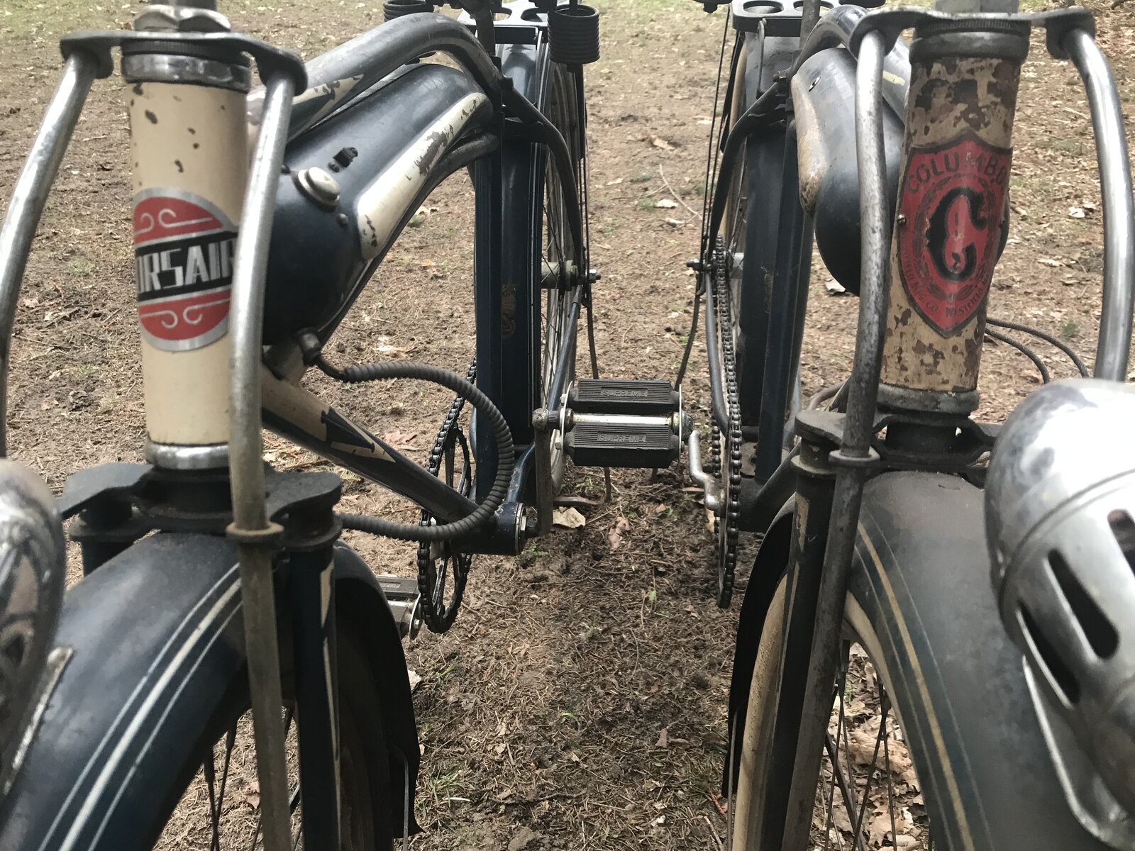

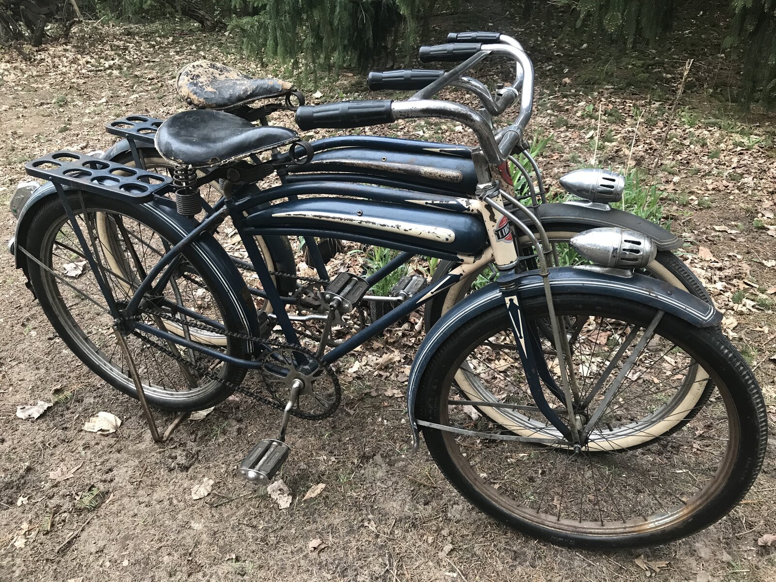

Here are a couple of 1936s I own. The one in the background is A180777/C9 and the one in the foreground is A263420/C12. Both have ND rear hubs.

Chris, thanks for sharing those details, I appreciate it greatly. It's good to see such a similar pair. I think they have different headbadges, I would be interested to know what they are.?
A263420 is the latest bike I have recorded for 1936. The last bike was A266083, and on average they were making 720 bikes a day, so this should have been made in the last 3-4 days of the year.

The bike in the foreground has a Corsair badge. The background bike has a Columbus badge. Here’s another picture of the pair
1392014

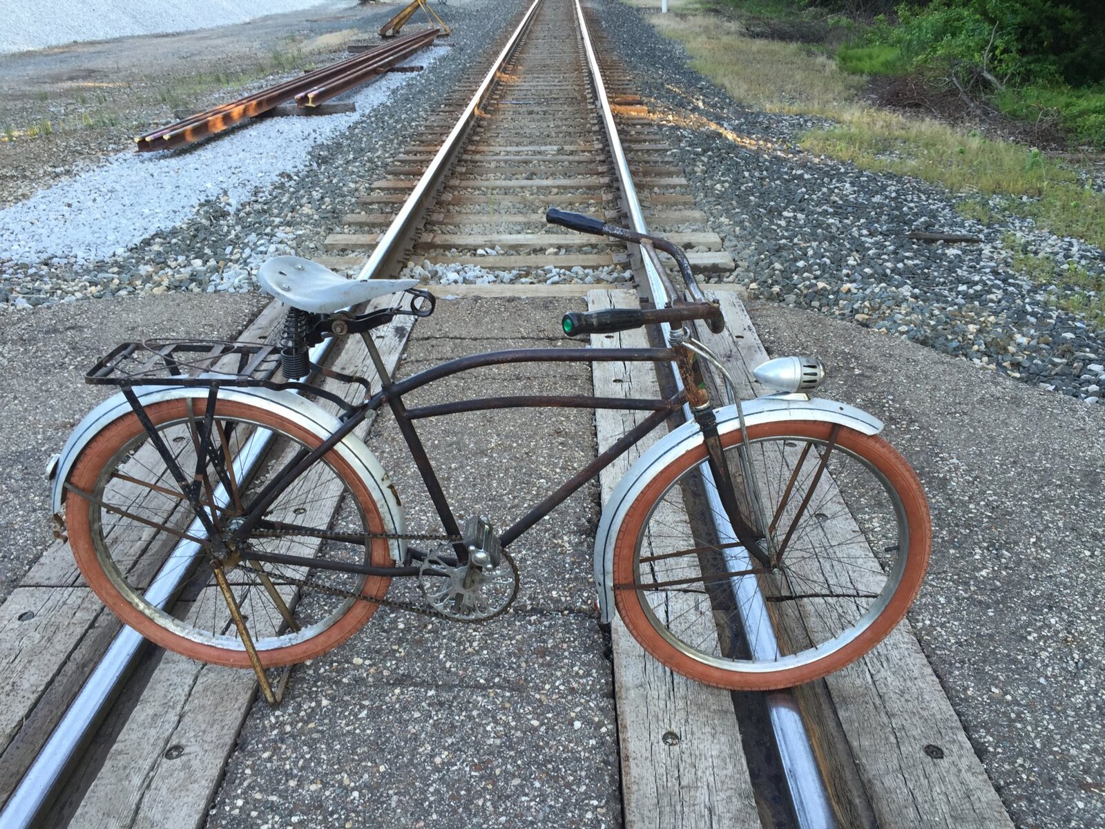

I also have this Westfield built double bar with an Elgin badge. These are quite an uncommon non catalog frame. B39543/D4
1392019

Thanks for the update with another frame, and the model names. Westfield had a huge variety of these, a lot left over from the ABC days.
